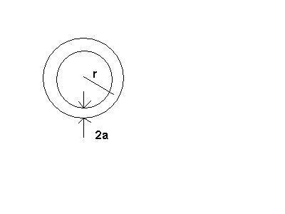

3) A conductor of radius a is bent into a circular loop of mean radius r. If r = 10cm and 2a = 1cm, calculate the internal inductance of the loop.
Answer : 31.42nH
Really can't the number 1 answer. I get a^3 in my answer. Number 2 no idea since L = L(in) + L(ext). As well as number 3.
