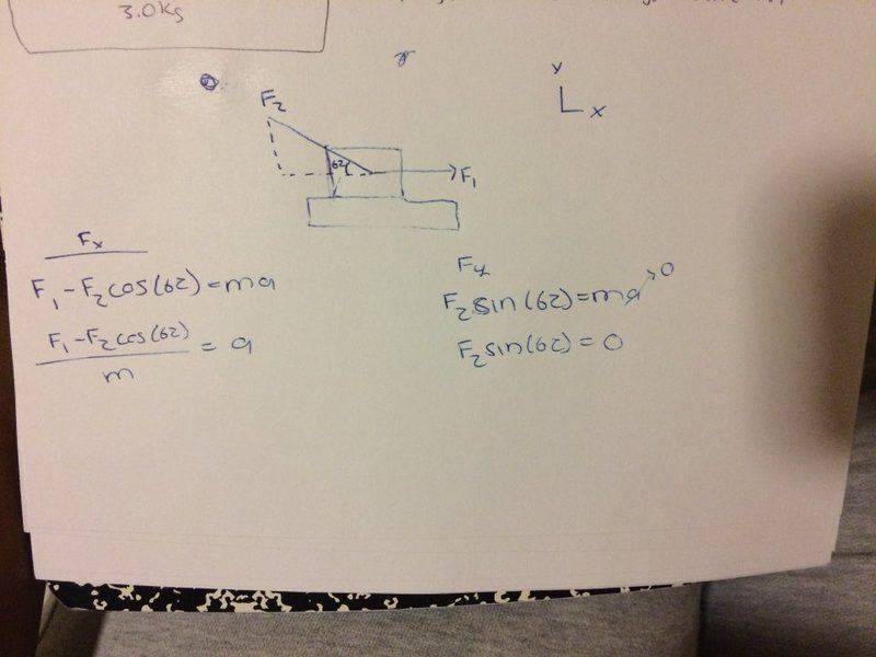

I wrote down in picture [/B]
F=ma
Worked out in picture [/B]

North, South, East, and West, unless stated otherwise, are directions parallel to the (locally flat) surface of the Earth. In your diagram, you have the second horizontal force, whose direction is described both as being horizontal and being "62° North of East" pointing upwards, away from the ground, with an angle of 62° to the normal to the ground, and partially acting against the vertical force of weight.That direction, normal to the ground, is not called North. It is either called "the normal to the surface", perpendicular to the ground, or zenith.
The given description, however, is meant to convey a direction that is 62° in the northward direction, starting from the direction of cardinal West. There is no vertical component described for that particular force.
As there are no forces described acting vertically, we can assume the normal force of the ground on the block and the weight of the block add up to a net vertical force of 0. So your free body diagram should only have the two horizontal forces described.

So when I take those off. My x components are still right. When I sum of all my components in the x direction I should have f1-f2cos(29)=m•a

Not quite. Your diagram has the second vector's direction as 62° West of the North cardinal direction. The description in the problem, however, says the vector should be 62° North of West, which, in your diagram, means we start on the West direction (the leftwards pointing horizontal axis in your diagram) and we move 62° clockwise towards the North direction. In other words, the net East-West force should be F1 - F2cos(62°).

Ohhhhhh. I see that. If it said 62 west of north. Then I would draw my angle 62 degrees from my north direction. Thanks.
Now we have (f1-f2cos(62))/m =a. We have solved our problem.

That's it! However, this is only the East-West component of the acceleration vector. There is also a component of net force in the North direction, which gives us a component of acceleration in that direction as well. Once you have both components, you can find the magnitude of the acceleration vector in the usual way.

The acceleration in the y direction would be zero so that shouldn't count right.
F2sin(62)=ma
But a =o

Why do you believe that the acceleration in the y direction should be zero ?

Because the box is not accelerating in the y direction. Is only moving along the x direction as it moves across the frictionless table top.
So since it's not moving in the y direction the acceleration is 0

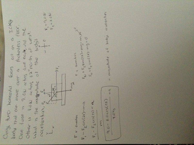

Okay I solved for a for my final answer

Why do you show the ice rink below the puck? You are looking down on the rink from above, so all you'll see is the round shape of the puck.
I ask this, not because I want to see a better drawing, but because you're still not getting the right answer and I'm trying to get you to see why so you can fix it.
By the way, the northward direction is not up. It's a direction that lies in the same horizontal plane as east and west.
I realize that nothing you do in your class is in three dimensions, but you still need to be able to orient the two-dimensional plane you are working in. That plane could be vertical or it could be horizontal. In this case it's horizontal but you are thinking of it, and drawing it, as if it's vertical.

I thought we were looking at the block from the side, like if it were sitting on a table and we were trying to calculate the forces then. Then the way I drew the vectors would be right.Is the answer wrong like the numerical value.

I would say the plane was horizontal which is why I drew the little graph showing that the y was up and the was horizontal
If the plane is horizontal, up and down are perpendicular to the plane and will not appear as directions in that plane.
You do not have the right answer, but you are now on the right track. And the way you show and do your work is excellent, too.

No it's going to be a vertical xy plane to make what I suggested true

I'm looking at the puck from the side not on top for this problem. But I do understand what you were trying to say now that I go back and read your statements
If you're looking at a vertical plane the two horizontal forces acting on the puck cannot both appear in that plane. For example, if one of them is towards the east (to your right) the other cannot be drawn in that same plane, it would be at an angle to that plane.
Like I said, best to use a horizontal plane.

Would that change my answer for my acceleration??
Yes, that's the idea.
Go back and read the problem again. Think of the two forces given in the statement of the problem as forces applied by strings tied to the puck. Those two forces combine to form a net force. That net force, divided by the mass, gives you the acceleration.

Ok I went back and looked at it from you point of view and totally get what you were talking about with the whole puck thing. The normal force and gravitational force are in the z direction. Okay I got that point now. The xy plane is horizontal to the z plane which makes sense. So there should be movement/ an acceleration in the y direction. From that view
X
F1-f2cos(62)=ma
Y
F2sin(62)=ma
Rewriting
X
(F1-f2cos(62))/m =a
Y
(F2sin(62))/m =a
Now how do we combine them

Just like you drew it in your original picture, except you would omit ##m \vec{g}## and ##\vec{F}_N##.
