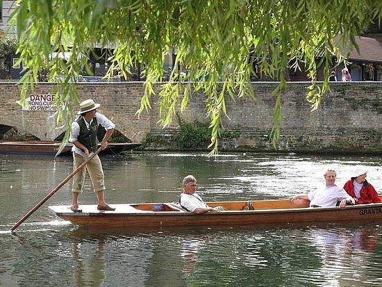

Man on boat rows
Is actually not such a good title. Punting is the word.
Students do it at Oxford and Cambridge. The english learned it from the dutch in the sixteenth or seventeenth century. 'Punteren' was the means of local transportation in Giethoorn well into the twentieth century.
