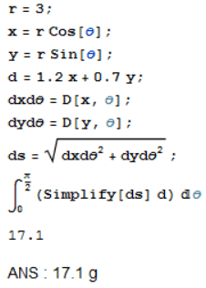

A quarter disc of radius 3 cm lies in the first quadrant. The areal density is (1.2 g/cm3)x + (0.7 g/cm3)y. Determine the mass of this object.
For my bounds:
x: 0 to 3
y: 0 to Sqrt[3 - x^2]
When I took this integral I got 2.07846 + 5.87878 I, which is obviously an imaginary number. Any idea how to get a real number? I'm not sure where I'm going wrong-- I thought this was simple calculus 2.
UPDATE: I have converted to polar coordinates, giving density = 1.2 r Cos[theta]+ 0.7 r Sin[theta]. Then I solved the following integral:
This gave me 8.55 g which was incorrect. Where am I going wrong?
Your bound for y is wrong, draw a diagram with your bounds (e.g. y as a function of x) and you'll see that's not the bounds of a circle quadrant. Hint: the relation is x^2 + y^2 = 3^2
If you check the units of your expression, you'll see that they don't work out. Your mistake is in the area element for polar coordinates.

UPDATE NO. 2:
I figured it out.
Thank you everyone for your help :)
You stumbled onto the correct answer, but your work isn't correct.
