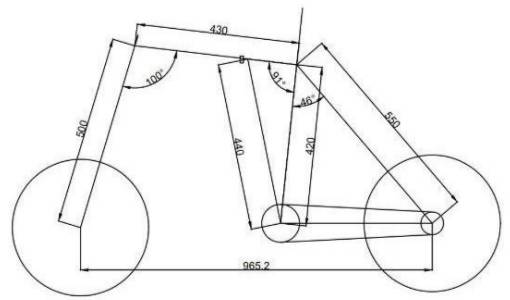

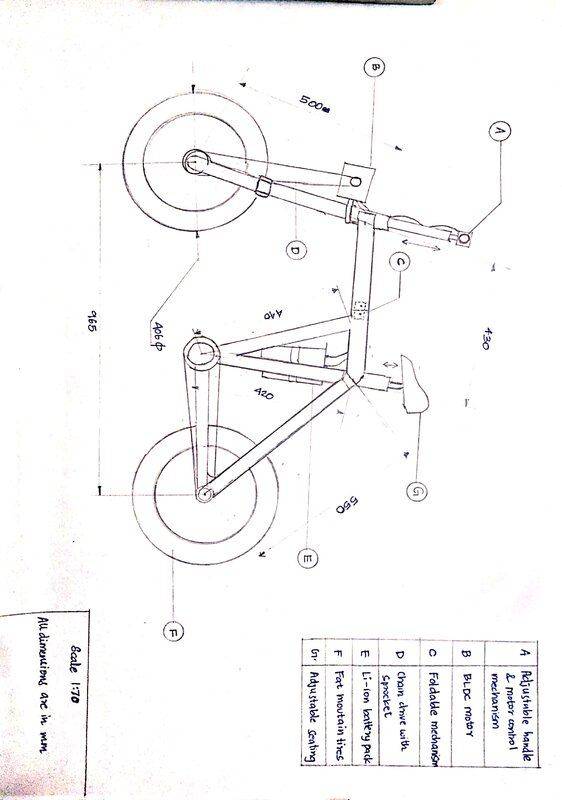

Summary:: Please help me to determine the thickness of the material of the bicycle given, i need a step by step procedure. I know the formula required but can figure out the forces acting and reactions on the bicycle. The weight of the person riding the cycle is estimated to be 70-80kg
Help me
  • Hand-drawn side-view technical sketch of a folding electric bicycle with labelled parts A to F and dimensions in mm, scale 1:10, with a parts list table at bottom right.

  • Dimensioned side-view line drawing of a bicycle frame with two wheels, showing lengths 430, 500, 440, 420, 550 and 965.2 (wheelbase) and angles 100° and 91°, 46°.

There are many things still unspecified.
1. Is it a folding frame, or why is the cross bar not triangulated to front ?
2. Is the structure built from round tube, elliptical tube or else ?
3. Is the material steel, aluminium or carbon fibre ?
4. The weak point is the tube with steering bearings, more detail is needed.
5. The quality of the track will multiply the rider's mass many times.
6. What are the unusual features of construction and use ?
7. Why are you reinventing the bicycle ?
More thoughts...
The front half of the frame is too floppy. As it is, it will become unstable at some speed, oscillate, and the frame will be destroyed.
The hinge needs to be implemented by two separated hinges with hinge pins in-line. When riding, the rider's applies force to the handle bars, to oppose the forces on the pedals, or the rider will fall. That requires a much stronger link between the handle bars and the pedals.
The wheels are too small, so the pedals, (if it has them?), are too close to the ground. They will strike the road while leaning on corners. The pedal crank length is proportional to the length of the rider's legs. Only bikes for small children have short cranks and so can have small diameter wheels.
For rough surfaces you need larger diameter wheels to smooth the surface contact. Wide soft tyres are good on soft soil, but not good on rocky tracks.
The problems with bicycle frames is the joints between the tubes, not so much the thickness of the tube wall.

1. Yes it is
2.That is yet to be decided, most possibly square bar
3.That is yet to be decided. (steel is 1st choice)
4.We just came up with this idea for our project. Please provide some insight if u can
5. Didn't quite get that
6.we are designing it to suit large office spaces, college campuses etc
7.It is needed because we are asked to bring novelty in our project ideas

Even though I'm embarrassed to admit that I'm final year student in b-tech and doesn't know half of the practical applications, you pointed out pretty good weak points. This design is just a rough model and we are still in the beginning phase. So you are saying that the folding mechanism should be changed and the ride height should be adjusted. Right? If you could direct me to some website where the approximations of the frame are done, it would be helpful

I would proceed to find the stress associated with flexural formula and search for the material which falls within the parameters
My main problem is the free body diagram of the said bicycle and the resultant stress

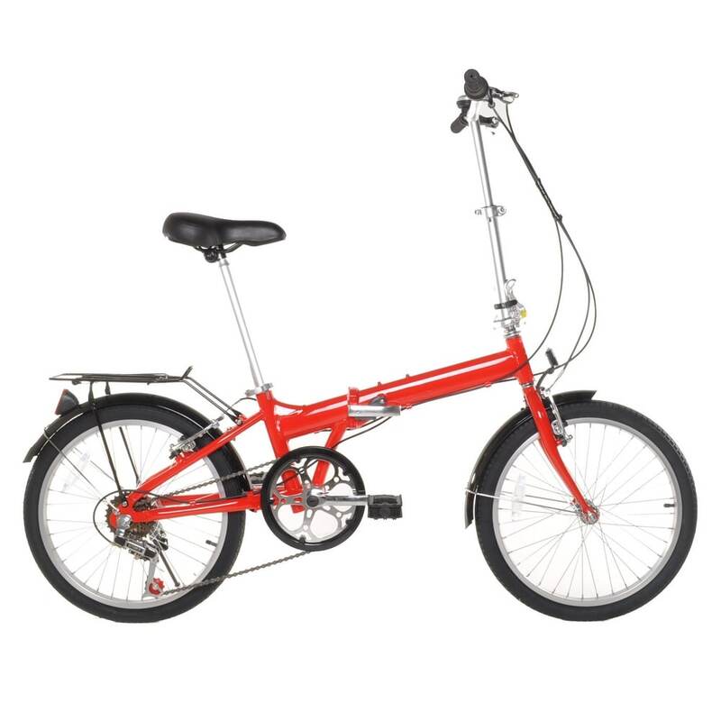

I would recommend starting by studying the details of some successful commercially available designs.
Please, see:
https://www.bicycling.com/bikes-gear/a20048132/best-folding-bikes/
The most common solution is a 20-inch wheels bike.
Note the main horizontal tube, which must be robust enough to stand the bending and twisting forces of the road.
Side view of a red folding bicycle with 20-inch wheels, black saddle, rear luggage rack, and a folding hinge in the frame, on a white background.
