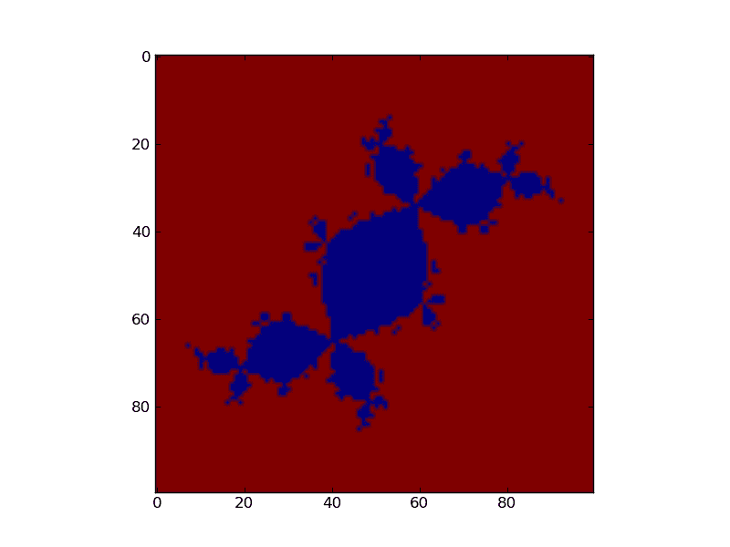

  • #31
GreenPrint said:
Interesting their identical to each other.
Yeah they should be identical, but just testing.
Anyway that means the difference must be in the previous lines of code. I've come up wit ha test that should indicate where the difference is occurring if you could take the time to test it for me GreenPrint.
Could you please just try entering the following into a MATLAB interactive session.
Code:
> y=[1:10]
y =
    1    2    3    4    5    6    7    8    9   10
> x=zeros(size(y))
x =   0   0   0   0   0   0   0   0   0   0
> b=(y>6)
b =  0   0   0   0   0   0   1   1   1   1
> x(b)=5
x =  0   0   0   0   0   0   5   5   5   5
> b=(y>4)
b =  0   0   0   0   1   1   1   1   1   1
> x(b)=8
x = 0   0   0   0   8   8   8   8   8   8
I'm really interested if that last statement causes all of the 5's to be overwritten by 8's as per my results above.
Thanks in advance. :)

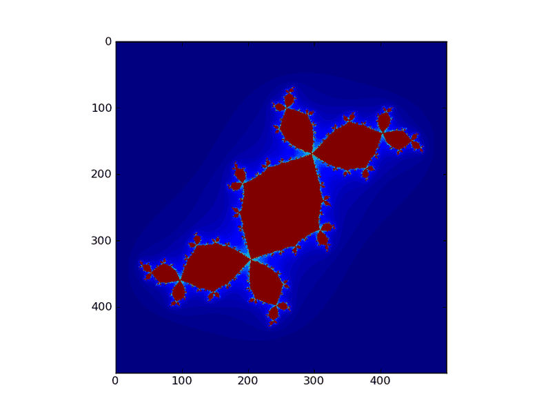

  • #33
What are we able to conclude?
  • #34
- Mathematically it's easy to prove to for all [itex]|z|>0.5+0.5 \sqrt{(1+4 |c|)}[/itex], (about 1.503), that [itex]|z^2 + c| > |z|[/itex].
- sqrt(5) is obviously greater than 1.503, so it follows that if |z|>sqrt(5) at any iteration, "k", then it will be greater than sqrt(5) for every subsequent iteration.
- This means that the set of all points where |z|>sqrt(5) grows with every iteration, and hence your map overwrites all previously written "k" values with the current value of "k" at each iteration.
- This means that at the end of the 80 iterations the map can only contain unwritten entries (which are zeros by initialization) and 80's. So we have a map with only two levels, which is exactly what I get with your code.
- So the only conclusion is that it is mathematically impossible for you to get multilevel maps you're getting. But yet you get them. :cry:
I really need someone else running your version of MATLAB to test this.

interestingly enough, just a while ago, i was running through my file in which i saved my home work problems on and ran into this cell and ran it and got a monochrome image. I was like O.O weird. I ran it another time and the same thing occurred. After being in shock I did a clear, clc and ran the cell again an produced the image that I had been producing before, a multicolored image, the same exact one.
I just think it's all very weird.
Also, how would you recommend handing in a assignment in which you are learning how to use MATLAB? I would imagine the best thing to do would to be handing in a .m file were each problem is a different cell. I'm noticing that there is no really great publishing option sense they all result in errors if you have user input functions in your file that you are trying to publish.
The immediate difference that I'm running into between the different versions of MATLAB is how MATLAB's symbolic tool box used to be based off of Mapple and now it runs through MuPad. It would see that the older versions of MATLAB that used the Mapple interface were stronger at solving large polynomials and could return exact answers for really complicated expressions, some that wolfram alpha can't even solve while the newer versions of MATLAB seem not to be able to do such. My book was written back when MATLAB could solve such equations. The examples however that include making the Mandelbrot sets seem to work exactly as they should on the newest version of MATLAB and apparently were suppose to produce the same results in older versions.
I just didn't realize how drastically different the versions were. I actually understand it now lol ^_^ and agree with you that it shouldn't be producing a multicolored image, but for some unknown reason it does @_@

For anyone interested, here's the same code in Python using the third party Numpy and Matplotlib modules. Linux or windows or Mac of course. I read that Numpy runs some orders of magnitude faster than Matlab and of course Python/Numpy requires no license fee.
Code:
import numpy as np
import pylab
import math
iterations = 80
N=500
x,y = np.meshgrid(np.linspace(-1.5, 1.5, N), np.linspace(-1.5, 1.5, N))
c = -0.123 + 0.745j
z = x+y*1j
map = np.zeros( (N,N))
sqrt5 = math.sqrt(5)
for k in range(iterations):
    print "iteration:",k
    z = z**2 + c
    a = np.where(np.abs(z)<sqrt5)
    map[a] = k
pylab.imshow(map)
pylab.show()

Sure. The orginal, abs(z)<sqrt(5):
and the almost(?) monochrome image obtained from
abs(z)>sqrt(5):
  • #54
mheslep said:
abs(z)>sqrt(5):
Arrh. That's exactly the image that Greenprint is getting and that we're having difficulty explaining. You see that's actually far from a two level map, there are lots of different shades and colors in that image, which implies that the map "matrix" must contain may different numbers, but I can only explain two of them!
Anyway I'm currently installing those python packages and am just about to try and reproduce you code. Hopefully I'll be able to get to the bottom of it once I see the results for myself. :)

Mystery solved !
Ok once I got the python code running it didn't take long to figure out what was happening. In the end it turned out to be fairly simple, the gnu-Octave I'm using thinks infinity > sqrt(5), as do I, but Matlab and Python think otherwise.
Well actually it's the way the respective programs handle numerical overflow. There are regions on the map that begin with |z|>2, so not surprisingly when you keep repetitively squaring this you soon get a numerical overflow, (((2^2)^2)^2)^…, it only takes about 10 iterations to exceed even a double precision floating point capability. When this happens Octave returns "+inf" for the absolute value, while MATLAB and python return "nan" (not a number).
So that's it. All the lovely shading that Greenprint (and his MATLAB textbook) have been getting in their images have been purely the result of bad programming and a glitch in the way the MATLAB handles numerical overflow. :biggrin:
