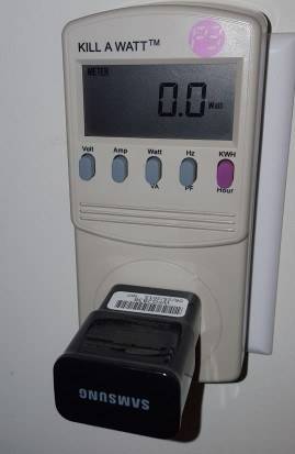

Okeey, so let's see how it looks. FYI, the voltage was measured at 120.7V. First-up, an unconnected phone/tablet charger (2.1A rated):

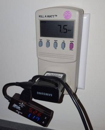

Surprising: No load detected. Next, charging a cell phone:

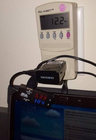

So, let's math that: 5.26V at 1.17A is 6.15W or 82% efficiency. Not bad at all. Next, a tablet:
Efficiency this time: 81% at a much higher power. So from half load and up, the efficiency is completely flat. I'll be interested in seeing if I can tell what it bottoms-out at with little load. To do that, I'll have to fully charge my cell phone and see what it does while just maintaining. Maybe later after it charges...

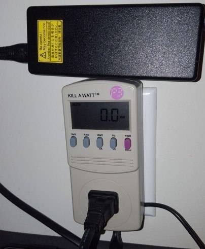

Next, my laptop PSU with no laptop:
That surprises me a lot. I was sure it would show something. Looks like these "wall warts" are actually pretty good.
