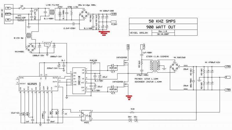

Hi, I am building this smps (schematic attached ) I have a question, since it's a half bridge topology the other end of the transformer primary is attached to half the mains rectified (capacitor middle) via a capacitor ,
but here's the question , the transformer primary is attached via a capacitor to the middle point of the smoothing capacitors which makes now two capacitors in series to ground and to +ve, if I am correct that makes the maximum voltage attainable at the primary not half but 1/4 that of the mains rectified correct?
can I just connect the float from the primary directly inbetween the smoothing capacitors without the additional capacitor ?
my devices are IRFP 460 they handle up to 400v if i remember correctly.
No. The series capacitor 1uF/480V is necessary to make sure the current through the primary is balanced and averages zero.
If you connected the primary directly to the float terminal, the cap would need to move to the other side of the primary.
The capacitor also limits the energy transferred on each cycle of the conversion. It prevents high DC currents in the transformer primary.
I'm trying to understand this.
You are saying the transformer needs to be AC coupled, which makes sense.
Is the problem being solved that when the primary current doesn't decay to 0 (fully discharge) because of rapid switching, a DC current will build up. The DC current would have to flow through the 27K resistors which would unbalance the switching point.
Or are there different/additional issues.
The directly rectified mains that is divided up with that capacitor divider can be thought of as a fairly high impedance source at DC but a very very low impedance source at the switching frequency. A fairly clever way of doing it I guess when there is no transformer to use the center tap for this float node. In a perfect world I think the series capacitor in question could be eliminated but I would not do it. Slight differences in tolerances could cause an imbalance in that capacitor divider. The series capacitor will not cause any loss. It is only responsible for passing AC and at the switching frequency it will not even appear to be there.
Ok thanks folks for the responses , I think i got your point , will keep the capacitor , i have a 2.2uF/275V one , but since the voltage there is only half mains rectified i think it should do fine.
also I wanted to ask one more question , see in the attached schematic there is a feedback optoregulator " 4n25" now it has two zener diodes in series connected to it , I assume the zener voltage is choosen to be such that its about 4 volts below the maximum output of the rectified high frequency AC coming from the transformer?
Also can I use more than two zener diodes in series but each being a different zener voltage ?
I just need to get some particular voltage but I don't have the correct zeners at hand but I have other ones I could combine hem in series to get the needed one?
Firstly, the capacitor. You should stick with a 1uF bipolar capacitor. Reducing the voltage spec might cause a problem when switching the unit on or off. There is a reason why they specified those values. It needs to be a good low loss cap, not electrolytic. The ripple current is quite high.
Secondly, the chain of zenners. You can make the chain from what you have but check them before you turn it on.
The 4 volts is needed to allow for the opto-coupler LED voltage, plus takes into account the difference between zenner knee voltage and at what voltage the zenner will be conducting enough current to turn on the LED in the opto-coupler.
yes I found a wima labelled 1000/100 which I assume is meant 1000pF which is 1nf.
I put in a small potentiometer on the lead 6 of sg3525 to be able to change the frequency if necessary.
I only wonder what happens if I need say +-80 volts instead of 70, should I then put the zeners such that the voltage is about 76 volts to leave those 4v for the optocoupler led?
Yes, add up your zenners so they are 4V below the wanted output value.
Once you have it going you might adjust the combination slightly to bring it closer to the voltage required.

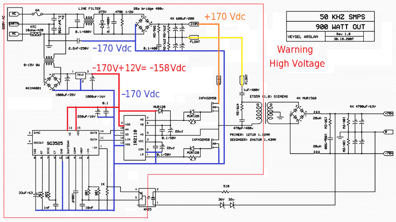

oh and one more question , is it okay that the driver mosfet ground is connected to the mains rectified ground but the grounds for both SG3525 and IR2110are connected to a separate small transformer rectified output ground?
see the attached schematic?
i have left all the small transformer ground with a black triangle and pointed out the mains rectified ground with red stripes as ground.

Salvador said:
for example if I need 80 volts I put 76 volts on the zener series connection and the feedback changes either the duty cycle or frequency? and the output voltage hence changes correct?
Yes. But it is not precise, it is simple design, maybe +/-1V.
All small triangles are connected together as a common reference. They are all connected to the negative of the rectified AC.
The small transformer and 7812 regulator provides a 12V DC supply on the neg rectified AC input. It is needed to start and run the converter.
You must be careful testing that circuit. I use a 1:1 mains isolation transformer and Earth the common reference when working inside live switching power supplies.
Notice that the transformers and opto-isolator form an island of floating supply, often with 350V DC and capable of killing. See attached.

well my question was about whether i can connect together the ground from the mains bridge rectifier and also the ground from the small rectifier that i have after the small transformer which feeds the IC's ?
the small transformer is made with a rectifier a smoothing capacitor and a zener which gives me about 24 volts DC that I feed into the sg3525 and ir2110, the maximum allowed for the sg is 35 volts and for the ir2110 25volts.
but should i connect the ground from the low voltage bridge rectifier together with the one coming from the mains rectifier?
I ask this because they are both separate units as we know and can't there arise some ground currents or unbalances etc?
is it possible to also keep the separately connected the mains for the driver transistors and the small ground for the IC's or isn't that possible because the IR2110 driving the mosfet needs both the +ve and ground as a reference to drive the gate properly or what?
All triangles inside the red box MUST be connected together. You must stop calling those triangles ground. Those triangles are all a common reference rail at the negative rectified AC voltage. They must not be connected to anything else as they are referenced to Earth for RF noise only through the 2.2nF/250V capacitor. For DC and power they are referenced to the rectified mains AC through the 'float' circuit.
You should not be working on what is called "live chassis" mains circuits without more experience. You are really beginning to worry me.
Live chassis circuits have only one aim in their life, which is to take your life. It will try to kill you when you least expect it.

The circuit attached here should make more sense.

Have you looked at the “Modified smps 2.png” I attached to post #15. The 7812 regulated supply is a quite independent and isolated 12V supply that is only needed to power the SMPS chips on the –170V rail of the rectified AC. It is needed to power the SMPS chips before the switching supply can start.

probably the IRFP 460 would have somehow driven the bulb i attached given that it would have been soft started or preheated.
still I doubt I would ever need this for the purposes on which I intent to use this smps ,
