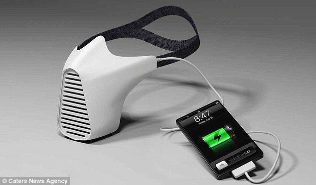

Phone charger by inventor in Brazil 2012...
http://www.dailymail.co.uk/sciencet...mask-uses-lung-power-charge-mobile-phone.html
Likes anorlunda
...and this is also why I'm more concerned about voltage.
Could you use breath to power a Van de Graaff generator :-)
CWatters said:
It says in the article this contraption uses turbines as well, but it seems as if the project never really took off, which makes me wonder why.
Generating electricity with human power has a long history of laziness stopping it. Humans are weak, frail creatures when compared to steel and hydrocarbons.
There is no free lunch. Producing electricity is work, no matter which muscle group you use. Other than some exercise fanatics, few are willing to do the work. (Myself included.)

The energy extracted by the mask isn't free. It would cause you to expend more energy. That would require you to burn even more oxygen which has to be generated by the mask causing you to expend even more energy etc
