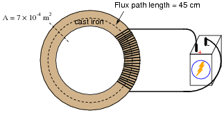

the circuit is simply a SinWave voltage source (ideal) connected to a single coil with an closed iron core inside. It would like the picture below while ignore the labels:
Diagram of a toroidal cast iron core with a winding of coil around it, labelled flux path length 45 cm and cross-section area A = 7 × 10⁻⁴ m², connected to a sine wave voltage source symbol.

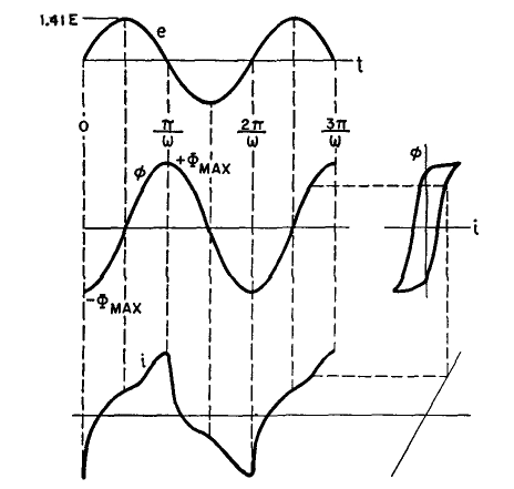

Only consider saturation and hysteresis of the core and assuming no resistance,no eddie current, no core loss or leakage, nothing else. the relation between the voltage of the source: e, the current in the coils I, and the flux ø, will look like this from ALL textbooks:
Plot of three waveforms against time t, with markers at 0, π/ω, 2π/ω and 3π/ω: a sinusoid e peaking at 1.41E, flux φ varying between −φMAX and +φMAX, and a distorted current i, plus a hysteresis loop of φ against i at right.
SO many textbooks just say:" Farady said v = -dø/dt, so if v is sin(something) then ø is cos(something)". I totally disagree, that's the induced voltage from a driving flux. Flux has nothing to do with voltage. flux is the result of current: N*i. However I am also aware of the fact that i won't be sinusoidal, as the inductance of the coil will be none constant, but I can not explain why ø is not affected in shape at all..

If the current is not sinusoidal while the circuit is driven by sinusoidal source of voltage, the magnetic core behaves non-linearly. This can be described by time-varying inductance ##L(t)##. If the wire has zero resistance, the electric field inside the wire has to vanish. Therefore the electric field maintained by the source of voltage has to be counteracted by induced electric field due to coil, so the induced emf ##d/dt(Li)## has to have the same magnitude as ##u_0\cos \omega t##. The flux ##Li## is therefore sinusoidal, but ##i## and ##L## do not need to be.

##Li## is equal to magnetic flux ##\Phi## , because we define variable inductance ##L## by the formula
\Phi(t) = L(t)i(t).
Now whatever the inductance does, the emf in the circuit is given generally by the Faraday law:
|emf| = \left|\frac{d\Phi}{dt}\right|.
(the sign can be found but it is trouble to argue it clearly, so let's leave it unspecified for the time being).
Since there is zero electric field throughout the wire, the induced electric field ##\mathbf E_i## due to coil is such that it counteracts the electric field due to voltage source ##\mathbf E_s##. Because of this, the integral of the induced field from one pole of the voltage source to the other (the emf) has minus value of the integral of the field ##\mathbf E_s##, which equals ##U_0\cos \omega t##. So we have
emf = -U_0\cos \omega t.
From the last two equations, we obtain
\left| \frac{d}{dt}(Li) \right | = |U_0 \cos \omega t |
so
|Li| = |\frac{U_0}{\omega} \sin \omega t.|
If ##L## does not vary in time (core is made of non-magnetic material or vacuum), the current ##i## will vary sinusoidally. If ##L## varies in time, neither ##L## nor ##i## have to vary sinusoidally, only their product has to, because the source of voltage enforces it.

But induction is more than that, V_source => currrent in winding generated=> Φ generated => counter EMF generated => current in winding reduced. Unfortunately the events seem to be all happening at the same time.OMFG, NVM. I just checked the real definition of L. I was totally misled by my stupid textbook
L = dΦ/di
so V_across the windings = Ldi/dt = dΦ/dt, and we reached this conclusion NOT because of Farady’s law.
If you use ##L=d\Phi/di##, then indeed ##Ldi/dt = d\Phi/dt##. But to reach the conclusion that this equals emf or -voltage due to source can be reached only because of the Faraday law.
Sir Jano, Thank you so much for your extraordinary patience and kindness.
If L=dΦ/di, then Ldi/dt=dΦ/dt ==> explains How that Flux was generated.
counter EMF = dΦ/di ==> explains what the effect of that Flux should be on the windings.
and from both views, both proved that MFlux was sinusoidal. Unified theory right there! Fully resolved.
