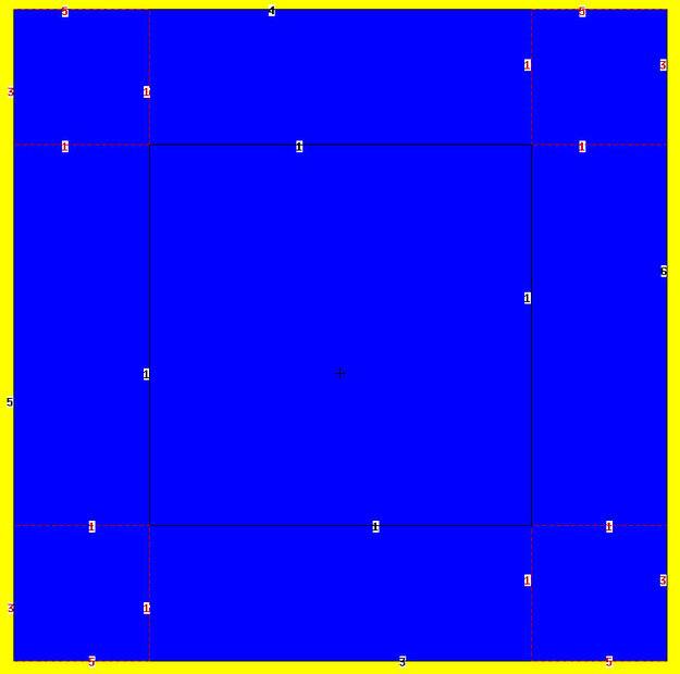

Hello,
I've been running into some frustrating issues with my MCNP deck. Photons are getting lost which is terminating the run file prematurely. When consulting the output file there seems to be some sort of geometry issue, but there are no fatal errors that I can see so I'm lost on how to resolve this problem. Any help is appreciated. The deck is listed below.

Please upload as an attachment with .txt added in future. Or you can use bbcode CODE tags which may keep most of the formatting for short pastes. I didn't see any obvious errors on reading so I fixed the formatting and ran mcnp with ip to plot the geometry.
Code:
mcnp ip inp=scotch
(let it do a default plot)
(clicked the plot> button)
px 33.101
extent 1.1,1.1
Which shows the Kapton tape, I think. The dotted lines suggest a geometry error in the corners. If this is four sections of tape those corner bits would be doubled up.
  • scotch.txt
    scotch.txt
Code:
mcnp ip inp=scotch
px 33.101
extent 1.1,1.1
Recoded the Kapton so that there wasn't any overlap and I'm still getting an issue. I think it has to do with cell 29 (my bounding sphere). Here's the output file. As you can see, none of the tally cells are recording any particles (in either energy bin).
First a typo that causes another geometry error,
Code:
23 RPP 58.42 59.42  -0.566 0.834  -0.834 -0.556     $ bottom off edge tally
566 should be 556, but that didn't solve the issue.
RPP shapes looks like nice closed surfaces like spheres but they are actually a macrobody that is translated into six infinite, flat, plane surfaces. Some of your tally cells have 0 as one parameter and that means there are plane surfaces passing through the origin where your source is. Never have a point source coincident with a surface. The cause took me a full day to figure out and I already know that rule! It also doesn't seem to make much sense, this is not a cell crossing boundary! It's still in the same cell! But moving the source location ten micrometers in each of the axes (x was probably not needed) seems to fix the problem.
Code:
SDEF POS=0.001 0.001 0.001 PAR=2 ERG=d1
Some suggestions, you removed the extra corner bits, but if they exist on the real thing you could add them on top. The efficiency of the problem is very low and this could be improved by putting the source closer to the foil or using a beam instead of an isotropic source.
Anyway, best of luck.
Likes MadGander and berkeman
