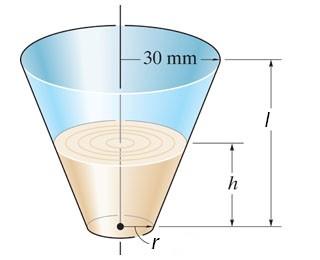

Determine the height h to which liquid should be poured into the cup so that it contacts half the surface area on the inside of the cup. Assume that r=11mm and l= 60mm . Neglect the cup's thickness for the calculation.
Surface Area = 2πXL
where X is the distance to the center of mass from the axis of rotation and L is the length of the line that is rotating.
