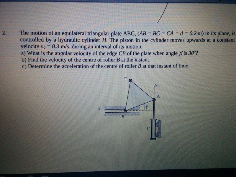

Mechanical engineering mechanics question: Motions of a triangular plate
17 replies · 3K views
sophiebeth100
Shown in picture
So far just used w=v/r
[/B]
Could only do part a.
W=v/r
=0.3/0.2
=1.5rad/s
For part b I would assume the velocity is zero? But I don't think that's correct. Any help with part b and c would be great, and is part a correct? Thank you :)
Hi beth, :welcome:
funny to see 'Shown in picture' for the problem statement, right next to the picture. It doesn't say which half of the picture constitutes the problem :smile:
You sure about your a answer ? Does it mean ##\omega## is in fact constant ?

Could you be more specific in regards to my answer for a? Did I use the right formula? Is there a different formula I should be using?
I asked first ! Where are your v and r and what is your axis of rotation ? Don't you become suspicious if the answer doesn't seem to depend on ##\beta## ?
I used the v for the hydraulic cylinder, 0.3, and the radius 0.2, as the edge of the triangle is.
I think I have found my mistake - I had assumed B was the centre of the circular motion but I now see that B can move and this is wrong. Since there is no fixed point on the triangle, I don't know where to go from here
Oh boy, back to the drawing board :nb).
There was something else I wanted to bring up: your equation comes from ##\ \ \vec v = \vec \omega \times \vec r\ \ ##, a vector product. You familiar with that ? In other words, if you want to write ##\omega = v/r## you can't just take any ##v##: you need the tangential velocity (the component perpendicular to ##\vec r##).
With that, do you now see an opening to get going with this exercise ?

I see. So when beta=30, the side CB is vertical. However, since CB=r, wouldn't the perpendicular velocity=0, since the machine only operates up and down?
Yes, they made a deceiving drawing. On purpose ?
Even if CB is vertical, the thing is rotating when A moves upwards: B moves to the right. So ##\omega \ne 0##.
Can you see a relation between ##\omega## of CD and ##\omega## of BA ? :smile:
[edit] typo: between ##\omega## of CB and ##\omega## of BA
Not because the machine only operates up and down. But because B only moves horizontally. So if you answer b) first you do have an answer for a) -- but you have to take into account that C also moves !
But perhaps the composer of the exercise wasn't that devious after all and gave you part a) first for a reason...

Do you mean of CB and BA? But hmm are they the same?
Very good. Next step: any relation with ##\beta## ?
I really can't find a relationship between those two things
What can you say about ##\beta## if the triangle does not rotate (only translates) ?
The value stays the same?
Yes. So what is ##{d\over dt} \beta## when it rotates ?
Is that the change in β related to time? Where does time come into it?
You want ##\omega## at the moment that ##\beta = {\pi/6}##. A is moving, remember ?
Do you know the definition of ##\omega## ? It is the time derivative of an angle. What angle in your exercise ?

Ah I see, so ω=dθ/dt
So to calculate the time, use time = distance / speed.
Not 100% sure on this, but is the distance 0.1m? Since it is half the height of one side of the triangle?
If that's right, time = 0.1/0.3 = 0.33s
ω=dθ/dt
ω=(π/6)/0.33
ω=π/2 rad/s
Is this right?
