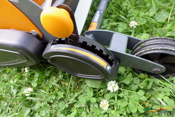

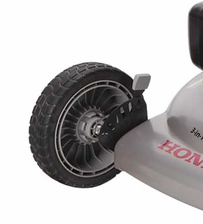

Typically this is done on current lawnmowers by adjusting the height of the wheels. I think your best bet is to follow the same route.
I'd agree, that'd need just one actuator, maybe a geared motor rotating the axis the adjustment handle does.

I'm not sure any of the complexity is needed, why not just have the wheels with drive motors mounted on the exterior of the frame, and they move up and down on arms? Sub-frames and belts for height adjustment seems like overkill to me, looking at current mower designs shows a bounty of simple designs.

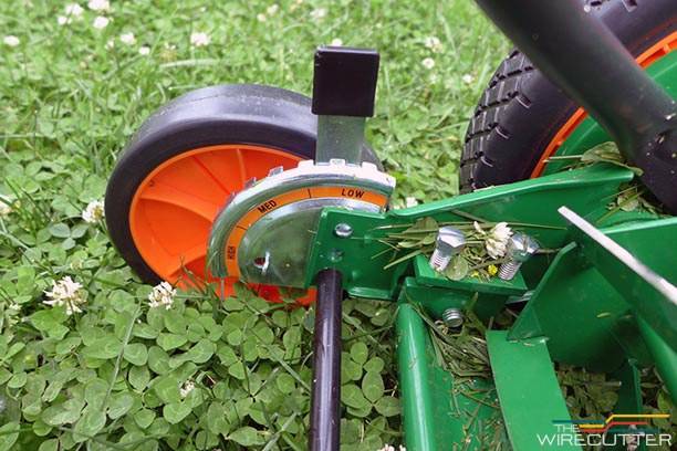

You can use a «single-touch» height adjustment on the 4 wheels as with this lawn mower:
You pull the lever 55 which rotates the rear axle 65. The rear wheels are offset from the axle, so they lift the rear of the lawn mower as the axle rotates.
The front wheels are offset from the front axle 63 in a similar manner as with the rear axle. The rod 58 connects the front and rear axles such that they rotate together.
