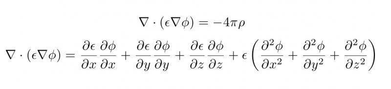

Hi,
As I see that maybe not many people use this scheme to discretize differential equations, I would reword this post. I have discretized a differential equation (generalized Poisson equation) in a real space grid. If you take a look to the attached file, this is the first equation. The left hand side of this equation can be rewritten like in the second equation. Then, I have used Fornberg weights to discretize first and second derivatives. Do you know if, a part from Bernt Fornbverg weights, there exist a better option?
