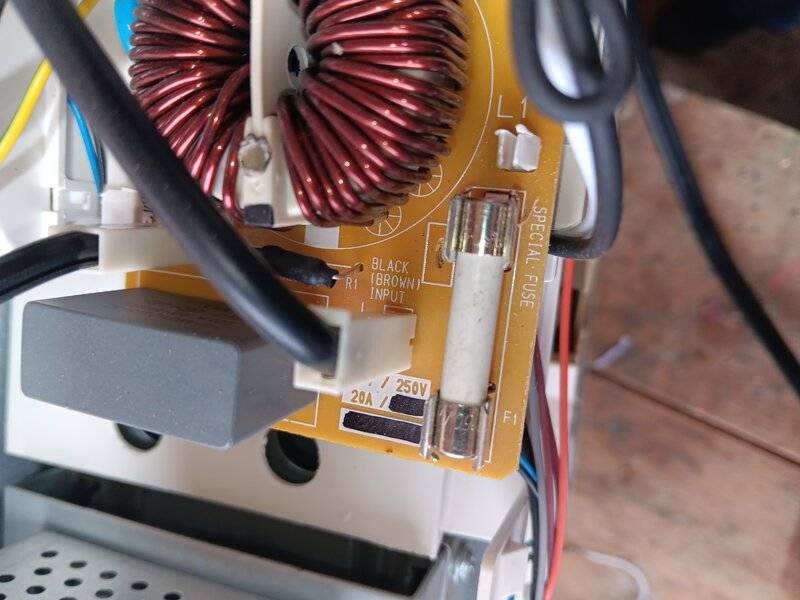

My Panasonic "science oven" was just minding its own business. I went to put something in it and the display went dark. Never even touched a button.
I tried it in another socket and it's still dead.
Should I even try to diagnose it before going out to buy a new one? Even to check the fuse, I'd have to crack it open.

I've found two common failure modes in μwave ovens:
1) An interlock switch that when the door is opened during operation, puts a direct short across the incoming power line. After a a few occurences, the switch contacts weld together -- this of course blows fuse/trips circuitbreaker whenever power is applied. It does avoid a cooked hand or eye though. Here in the US, the switch is often located at the bottom latch of the door (needs a fair amount of disassembly though).
2) The circuit board fails, either partially or totally. Sometimes a few of the buttons or display elements will still work.
A third possibility is the magnetron may have an internal short, thus blowing an internal fuse or the circuit board. I've never seen this occurrence, only heard about it.
For case 1), the switch is a common one readily available from electronics suppliers for a few dollars. If bought from the oven manufacturer, be ready to pay 3 times as much for it.

If it went dark with a loud crack, give up now.
If it went dark quietly, check the fuse on the internal PCB. Replace the fuse if blown.
If the fuse blows again immediately, give up, because you need someone expensive, in money or time, to diagnose and service the unit. Cut and run.
Replace the unit with a new one, and get on with your life and relationship.

Yup. I jumped the fuse and the lights came on.
So I need a replacement fuse. It's some sort of ceramic. The PCB labels it as (and I'm quoting here) "Special Fuse".
Looks like it's a common fuse for microwaves. Just dunno if it's 10A or 20A.
It may be marked on the metal bits.
The mains is 240V, so the wall outlet max current will be about 10 amp.
A 1 kW oven on 240V is about 4.2 amps, so use 250V10A fuse.
The fuse is special, ceramic so it will not shatter, and will extinguish, after blowing with a dead short at 250V.
The fuse is marked on its metal ends, I can see a bit of text between the PCB fingers.
Go with those numbers. There may be a momentary turn on surge.

@DaveC426913 is in Canada so it's most likely that his microwave oven is connected to 120V. (I've never encountered a 240V consumer microwave in North America.) I'm guessing that the obscured part of the white PCB label under the cord plug says 125V/20A and that's the spec for the fuse.
Ah. Thanks. It says 20A 250V.
Man, that's hard to read!
BTW, I am on 120V.

Twenty-amps at 250V is 5kW which is way too powerful for a home microwave. I'd use a 20A 125V fuse. I think the manufacturer spec'd the fuse for 120V-use which is why they blacked-out the label below the 250V marking (probably says 10A underneath) so as to avoid confusing the repairman and/or curious consumer. But they should have also blacked-out the 250V label.
OK. That jives with what others were saying, above.
Unless this is a very unusual situation, only the amperage of the fuse needs to match the specification. The voltage rating only needs to be high enough (so 250V will work fine in this application. Almost all household line fuses are rated to 250V so they will work "anywhere" and there is no need to duplicate the supply chain.
The voltage rating of fuses is separate from the current rating, multiplying them doesn't make much sense in fuse selection. It's about the worst case values, not the combination. The voltage rating is about clearing an arc in the fault condition, i.e. how much voltage is available. The current rating is normally about preventing fire from overheating of wires and such in fault conditions. It is determined by the size of downstream wires, traces, and sometimes components. It's not directly about normal operating currents. So for an appliance that runs at 120V/16A or 240V/8A, a 250V/20A fuse makes sense.
The "special fuse" label is really a work around for safety agency approvals, what it really means is "not user serviceable". Of course that's BS, you or I would replace it. The ceramic envelope is characteristic of fuses with a high interrupting current rating. So, don't get the cheapest fuse available (usually glass).
