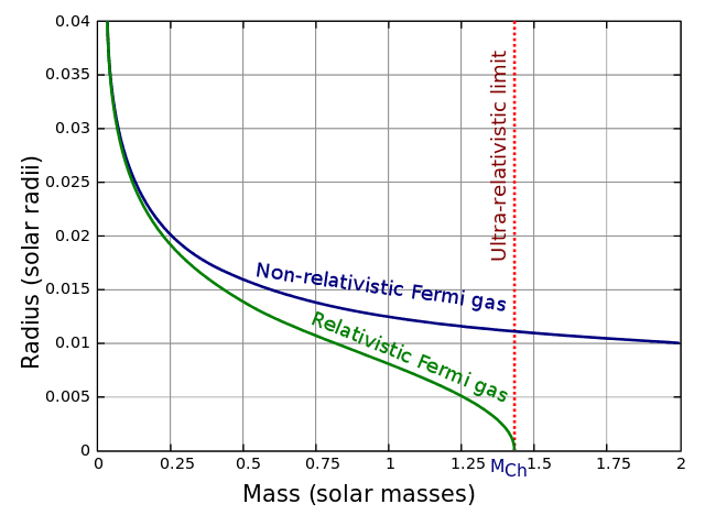

I find descriptions such as above to be a bit misleading. There is no "overcoming of degeneracy pressure". When you add matter to a white dwarf, it shrinks, it does not "resist".
Added electrons have to go into higher-energy states. Degeneracy pressure grows (not surprising: you need higher pressure to support a now-smaller WD).
Chandrasekhar limit is not a moment when degeneracy pressure "breaks" (it never breaks), it is a moment when most energetic electrons have enough energy for p + e -> n reaction. The "eaten" electron no longer provides pressure, and WD loses stability.
In neutron stars situation is similar. Adding more neutrons makes it shrink. And since NS in general have dimensions only a few times more than their Schwarzschild radius, there is a point when adding more neutrons will make it smaller than its Schwarzschild radius, after which it is a black hole. My understanding is that collapsing NS continues to push neutrons into ever higher energy levels even _after_ it is under event horizon: Pauli exclusion principle still works even there!
To expand on this a bit: if we would "switch off" the possibility of p + e -> n reaction, this would not make WDs stable. Adding matter to them would still shrink them, and as you near the Chandrasekhar limit, WDs would quickly become very small: they would shrink from being ~Earth-sized to a few tens of kilometers, and after a bit more added matter they'd go under Schwarzschild radius and become black holes.
