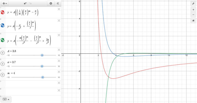

@Shomari, try choosing a value for ##m## and plotting V'(r) to see how the function behaves. That might give you an idea of how to solve the problem in general.

Okay, thanks for that idea. I plotted the graph and put in values for A, a and m. I didn't read the question properly, but I understand that if I want to know the minimum force required then I need to differentiate V'(r) to obtain V''(r), and set this equal to 0 and solve for r.
Once I solve for r I then substitute that value of r into the equation for V'(r).
