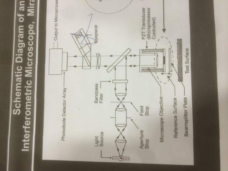

Hi everyone,
I'm building a white light interferometer and need help choosing and finding a white light source.
I'm using this mirau objective:
http://www.edmundoptics.com/microsc...ectives/nikon-interferometry-objectives/59312
Here is the setup:
I know that the light source will have to be collimated and go through an aperture stop, field stop, bandpass, etc. I was hoping that there was a white light laser that does these steps already so that I don't have to work with several different lenses and build a setup for them. Such a laser must exist, no? Does anyone know where I can find one? Ideally one that is 100-200 Watts? I've looked all over but am having trouble finding an manufacturer that makes what I'm looking for.
Are there any important steps that I'm missing? Should a collimated white light beam do the job?
THANKS!

from what I've seen, white light interferometry is not done with a laser. And that includes your sources that you posted. reread the first page of your document from fp.optics. White lasers are a relatively recent invention. And I believe it is a much more complicated solution.
I was under the impression that the steps described in the diagram (before the light even reaches the beam splitter) were steps that were typical of those carried out in a laser before it exits the laser.
most of that is totally unnecessary if your light starts out monochromatic and coherent. For laser interferometry, all you need is the laser, a beam splitter, a lens, and a mirror.

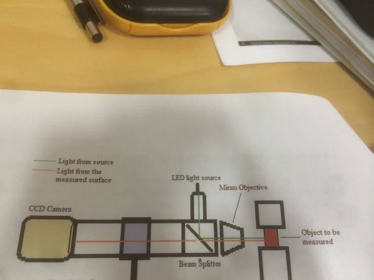

hi adamjts
on pages 18 and 19 of that document in your post #6
its shows their setup, they are using a white light LED ( Light Emitting Diode)
Dave
