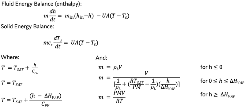

I don't. I can figure this out though. So to confirm, the two equations are the solid and energy balance here:

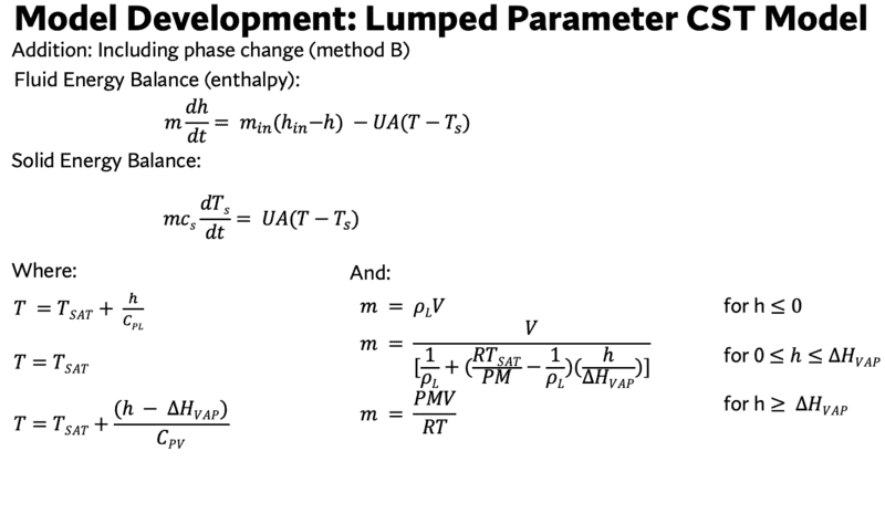

Where ##h## and ##T_s## are the two unknowns, and where the ##h<=0## correlations will be used for ##T## and ##m##?
Yes, the liquid region, and, for the analytic solution, you can use the constant heat capacity version of the equations. You are taking V as the pore volume, right? What values of the parameters are you using:

I've done part of the analysis (but I want you to also do it), and I've got equations for the time constant(s) in terms of the above parameters. This should tell us much more about the long time response.
Mass of liquid in bed
Mass of solid bed
Mass flow rate of liquid to bed
U, A,
Heat capacity of solid
Heat capacity of liquid

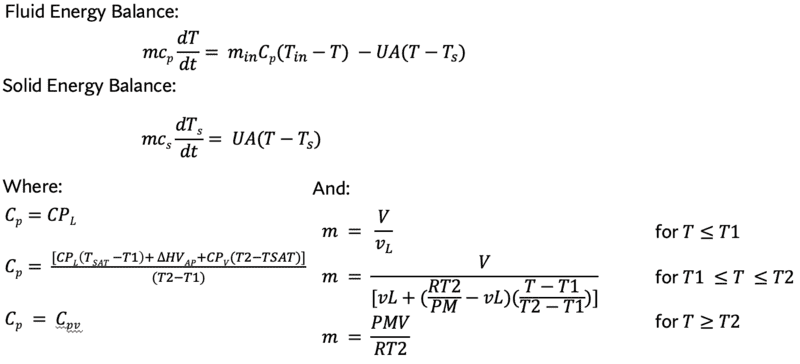

Understood, so these equations, for the liquid phase i.e. T<Tsat:
Yes V is the pore volume for this model

In regards to the analytical solution, what makes up an analytical solution in this case?
Are we talking about solving for the eigenvalues, or do we mean solving the linear system, i.e. to get h(t) and Ts(t)?
The general approach I was planning to take here is:
1) Differentiate one of the energy balances w.r.t. time to get the second derivative
2) Substitute the other equation in
3) Solve the first equation for h (or Ts)
4) Substitute h (or Ts) back into the second derivative equation
5) We'll get the characteristic equation from this as we'll have the second and first derivative of h, and h
6) then assuming ##\lambda_1## and ##\lambda_2## are the roots
$$h(t) = c_{1}e^{\lambda_1t} + c_{2}e^{\lambda_2t}$$
$$Ts(t) = c_{3}e^{\lambda_1t} + c_{4}e^{\lambda_2t}$$
Where c1-c4 come from h(0), Ts(0), h'(0) and Ts'(0). If this is the route we're going then one question I would have is what would the values of h'(0) and Ts'(0) be?

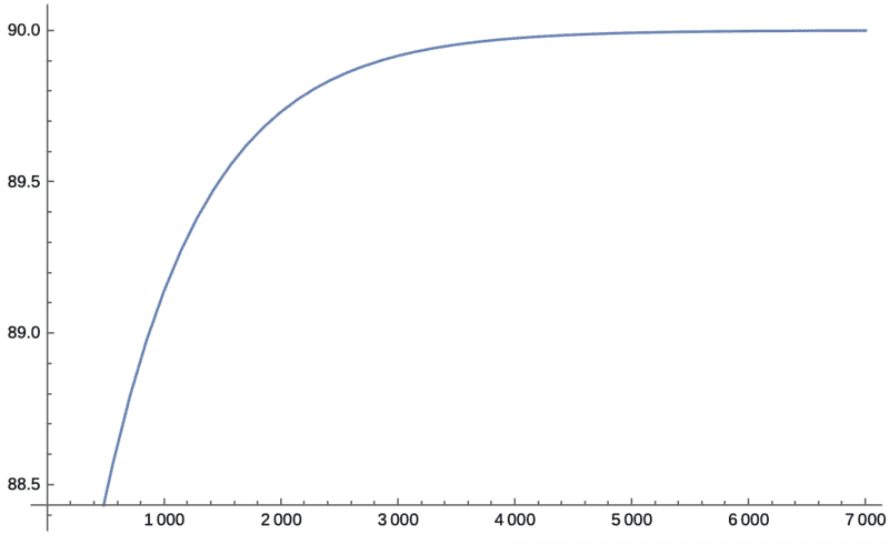

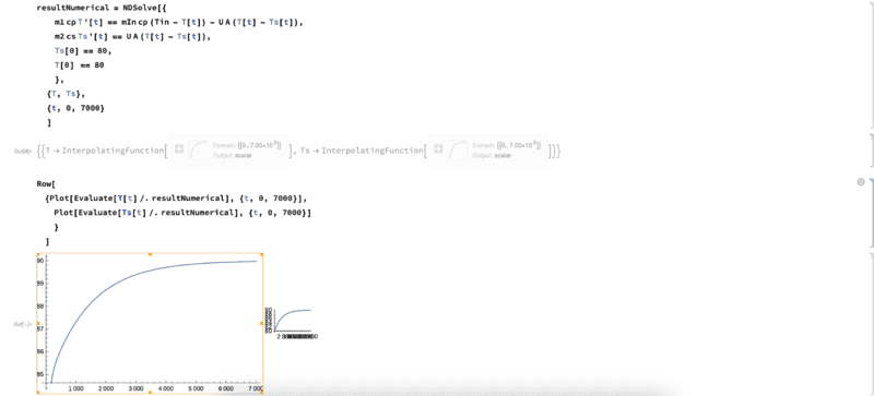

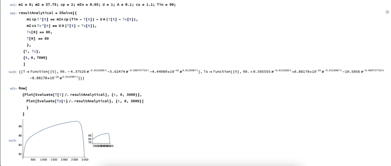

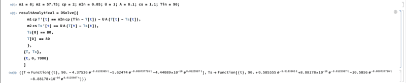

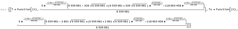

Hi Chet, update on the analytical solution:
I haven't been able to actually derive the analytical solution myself yet (seems more difficult than I first anticipated), however Mathematica does this and has solved the equations both numerically and analytically. I'll transfer the analytical solution functions (if correct) to Python. Here is the output for fluid temperature versus time (I have the solid plot also, its basically the same):
You can see the constant values I used, plus the T(t) and Ts(t) analytical solution functions output by Mathematica (the functions are blurry so I've typed them out at the bottom), and also the analytical solution graph from 0 to 3000s. Note it seems to curve off unexpectedly just before 3000s.
Here is the numerical solution, also done by Mathematica. The plot starts out similar to the analytical one, and continues to level off towards the inlet temperature indefinitely, which seems to make more physical sense. There is no unusual decrease in temperature behaviour happening in the numerical solution
Its late here so I'm going to check these plots against my own code first thing tomorrow.
Edit: The screenshooting doesn't seem to want to cooperate with the Mathematica page so I'm copying the analytical solution below. It doesn't seem to want to wrap at the end of the line (its two equations in the same line), so I will edit this tomorrow
$${{T(t) = 90 -4.37526 E^{(-0.0133365 t)}-5.62474 E^{(-0.000737726 t)}-4.44089*10^{-16} E^{(0.0125987 t)}]
and
Ts(t) = 90 +0.585555 E^{(-0.0133365 t)}
+8.88178*10{^-16} E^{(-0.0125987 t)}-10.5856 E^{(-0.000737726 t)}
-8.88178*10^{-16} E^{(0.0125987 t)}]}}$$
I haven't been able to actually derive the analytical solution myself yet (seems more difficult than I first anticipated), however Mathematica does this and has solved the equations both numerically and analytically. I'll transfer the analytical solution functions (if correct) to Python. Here is the output for fluid temperature versus time (I have the solid plot also, its basically the same):View attachment 293819
and
Their analytic solution is very puzzling because there are only two eigenvalues to the characteristic equation. Here is the eigenvalue equation I came up with: $$\lambda^2+\left[\frac{\dot{m}_{in}}{m}+\frac{UA}{mC}+\frac{UA}{m_sC_s}\right]\lambda+\frac{\dot{m}_{in}}{m}\frac{UA}{m_sC_s}=0$$
For the parameter values you showed in your printout, this gives $$\lambda=-0.0133$$and$$\lambda=-0.000738$$which matches their values (at least on the two main terms). This implies a time constant at long times of 1/0.000738=1355 sec.
Let's see how your numerical solution compares to their analytic solution..

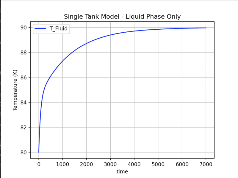

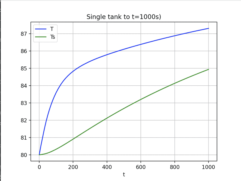

The analytical and numerical solutions from Mathematica now match. The problem was in how Mathematica deals with decimal numbers. So the graphs of T and Ts vs time now match.
And here is the analytical solution:
Editing my numerical solution now to compare.

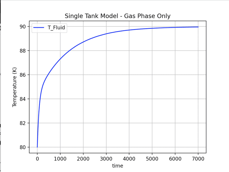

There we go, my numerical solution does seem to match the Mathematica one:

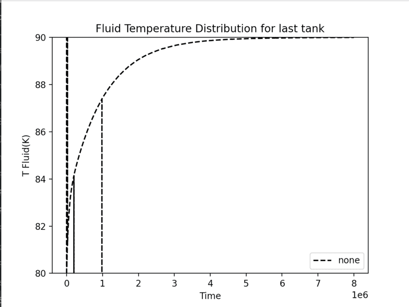

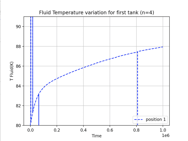

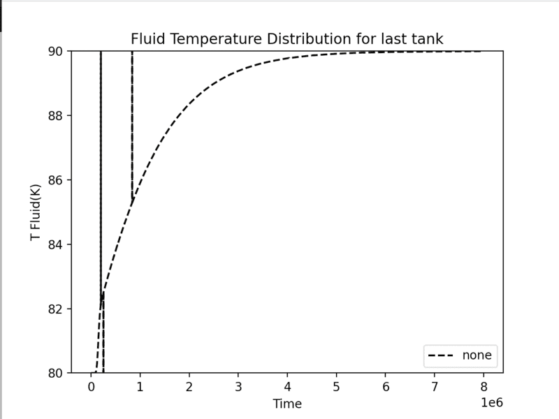

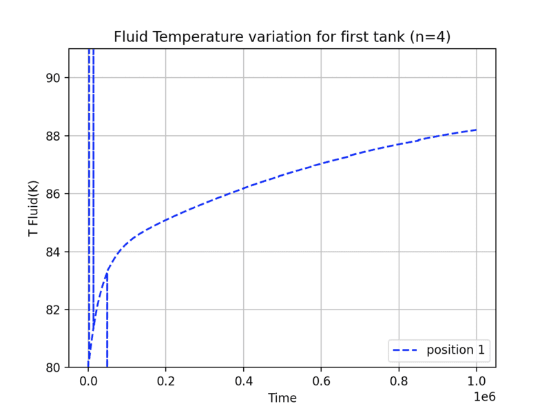

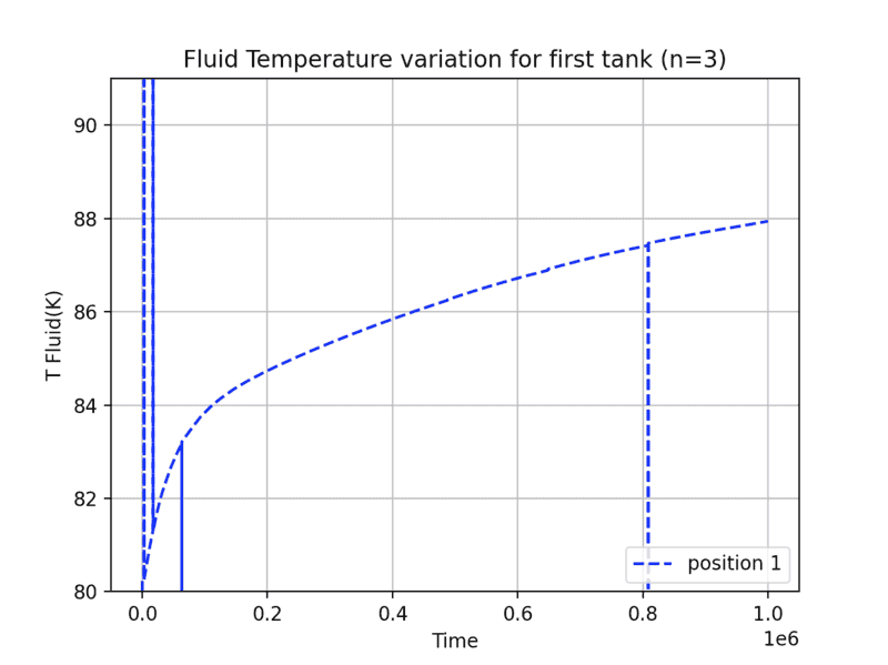

And here is the plot for the liquid phase temperature, using the spatial variation model, assuming n=2 (so the inlet conditions plus one spatial point). Ignoring the jumps, This also matches the other plots:
Note the time is x1000 (due to 1000 points calculated per time step) so dividing the x-axis values by 1000 gives the same values as the previous plots

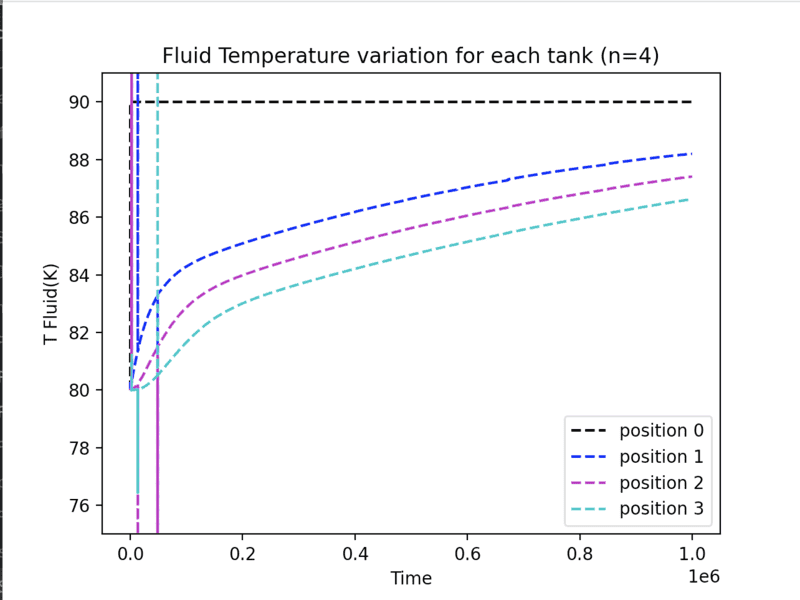

And lastly, I've set n = 32 and plotted the final position (index 31) versus time:
This also roughly matches the timescale of the other plots. Is this all reasonable to you?

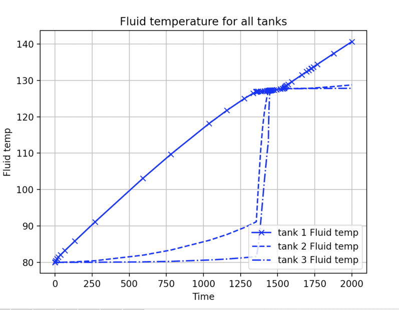

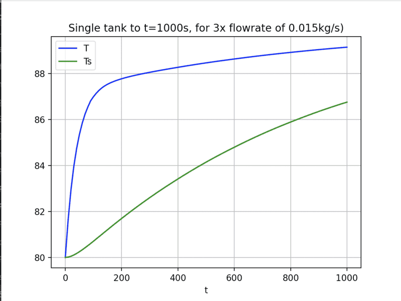

How about running the 3 tank version and plotting temperature vs time on the same graph for all three tanks? Don’t you expect a time delay between subsequent tank time responses as the wave travels through the bed?
Yes there seems to be a slight delay looking at the n=32 plot

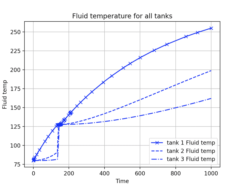

Here we go, this is for n=4. I went with n=4 so we can see three inner-tank Tf vs t graphs, position 0 is just the inlet condition.
As you mentioned we can see the time delay across the tank. The plot is quite messy due to these 'numerical bumps'. The output does look similar to the analytical and numerical output from Mathematica though.
Reverting back to the two phase model (assuming liquid in the tank, with a gas 300K input). Heres the graph for n=4. This also seems to approximately matches the timescale of the others:
Am I correct in saying this means that the spatial variation model is correct? i.e. no particular need to move to the model you outlined yesterday? I will code this up anyway but it seems the original spatial variation model is ok?

Can do, this is both graphs above, to 1000s, for the liquid phase only (90K inlet stream, bed initial temperature of 80K).
Single tank:
Spatial variation plot: for n=4:
The single tank plot seems to best match the first position here.

Here we go, this is a 3x flowrate plot for the single tank model. So the flow here is 0.15kg/s. Everything else is the same:
I will look into this overlay plot now. There is almost definitely a convenient way to do this

Hmm, this is the Mathematica analytical solution for 3x flowrate (zoomed to appropriate section because its fairly blurry otherwise):
Taking a reference point of 1000s, the temperature is just above 89, say 89.1K
Here is my numerical solution for the 3x flowrate single tank model (from above):
At t = 1000s, the temperature seems to be around 89K also, so its similar to the plot above. I think we can now say the Mathematica plot, and my single tank numerical solution are both correct
Multi-tank plots:
Here is the multi-tank plot for n=3, and m = 0.05kg/s:
At t = 1000s, the temperature is 88K, so its 1K lower than the single tank plots.
Am I correct to use n = 3 here?
Here is the plot for n= 4:
So t = 1000 and T = 88.3K or so. about 0.7K off.
I don't know if these are 'close enough' or not, but my guess is that they are not close enough. I'll run some diagnostics now in case it is not close enough
Multi-tank plots:
You need to compare the temperature vs time of the first tank in your multi-tank 3 tank model with the temperature vs time for the single tank model of the full bed, the latter at 3x the flow rate of the former. The two results should match exactly. I hope I’m making it clear what I’m asking for. This is a validation check on the multi-tank model.
The idea is clear, and I can validation check by using the values of the other parameters (h,m,Ts).
One question - I'm not clear on the correct value of n. My thoughts are that temperature is evaluated at the 'centre' of a tank. n=0 is at the inlet and n=n is at the outlet. So to have 3 'tanks', we would need n=5?
Either way none of n=3,4,5 give exactly the same solution as the analytical one, so I need to do some testing regardless
