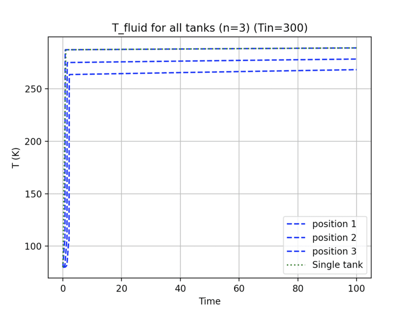

  • #274
Chestermiller said:
I would still like to see a comparison between the position model and the single tank model using the full temperature range, and comparing the 32-tank results from the position model with for the first tank with those using the single tank model with 32x the mass flow rate.

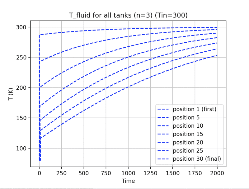

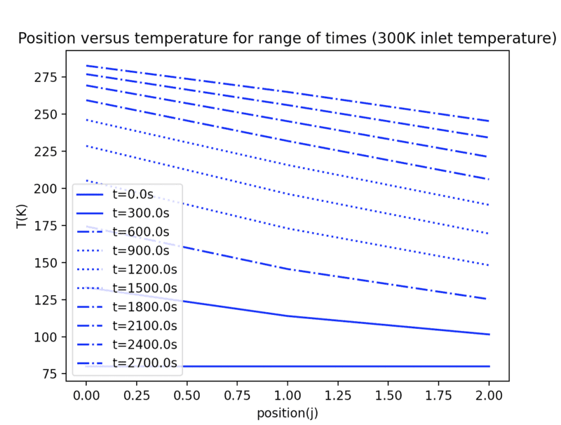

Position versus temperature for a range of times.

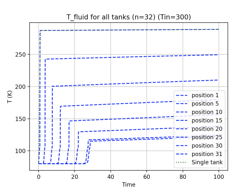

Time versus temperature for the n=32 model, for a number of tanks in the spatial variation model, and the single tank model. The first tank matches up with the single tank model almost exactly:
The single tank is hard to see but its there behind position 1. One thing that stands out to me here is the shape of the temperature distribution for each point. Its close to right angled. So the temperature at each point stays at about 80K, until the 'wave' reaches the tank, then the temperature jumps quickly, and after the wave passes the temperature just gradually increases again. This would suggest very low axial dispersion I think? How does the above look to you?
Will add those small Tsat/Hvap changes this evening
  • #275

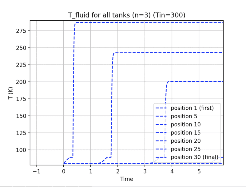

I'm wondering why there is no temporary leveling off at Tsat, and why there are sharp changes in slope with time at various positions. Also, what are the solid bed temperature variations with time at the various positions? (I did expect the wave to travel through the bed gradually at the lowest temperature as the graph shows)
  • #276
The sharp change I think is because that's the 3 tank model. This is the same plot for n=32, so these changes are smoothed out:
The model takes 2-3 minutes to run now each time so I'll look into speeding this up

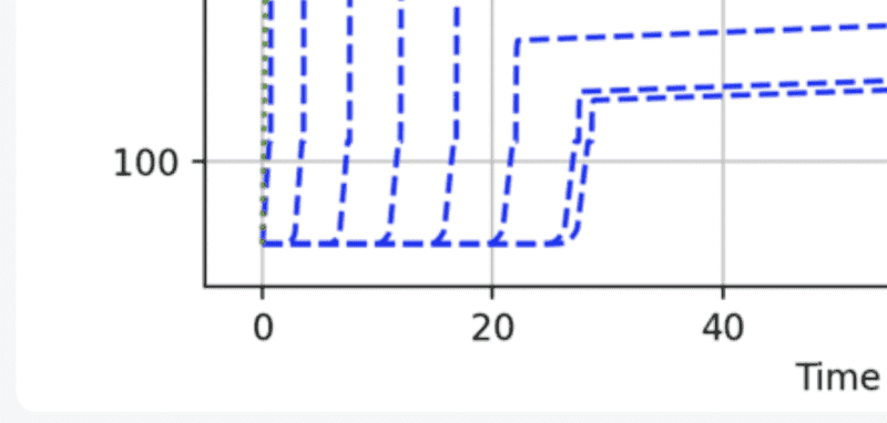

The temporary levelling off at Tsat does happen, however since the system is increasing in temperature quite quickly this zone is short:
Zooming in on it (a lot) you can see at 105K (Tsat) there is a levelling off of the curve to a constant saturation temperature of 105K. Its just a few seconds of saturation and then single phase again. Note this graph is n=32 (incorrect title however I left it as it takes a while to regenerate)

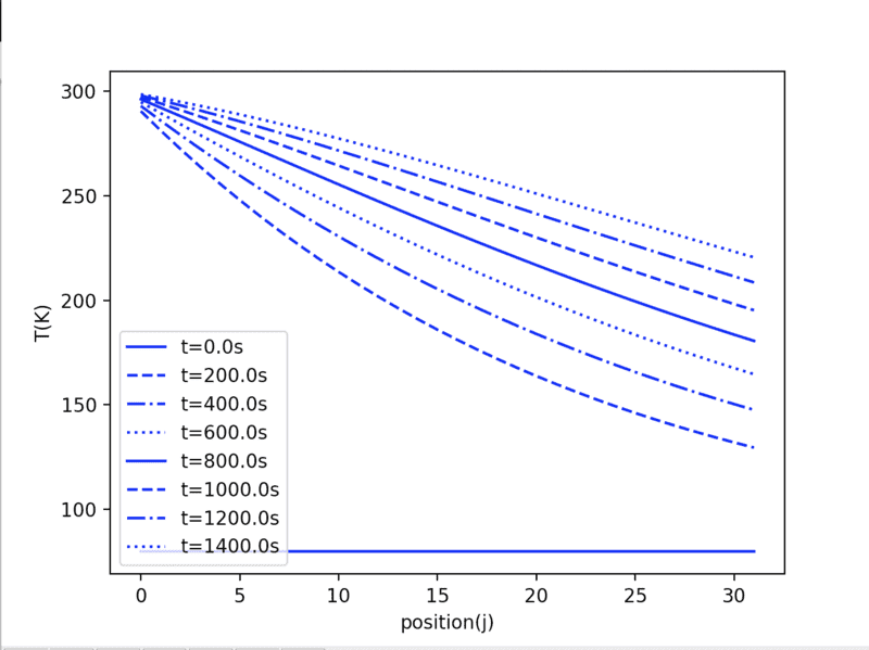

Position versus temperature for a range of times:
Time versus temperature for a range of positions, for n=32:
Zooming into show the levelling off at Tsat, 87K or so as expected

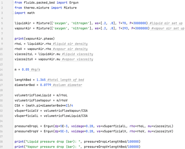

For the expected pressure drop across the bed, I first collected the actual values of flow/pressure/bed dimensions that will be used in the lab. I've modeled the two extreme cases, all vapour and all liquid. The actual pressure drop will be somewhere in the middle.
For reference:
Inlet pressure = 30bar
Mass flow = 0.05 kg/s
Bed length = 1.365 m
Bed diameter = 0.08 m
Voidage = 0.28
Particle diameter = 5mm
Heres the code for the expected pressure drop across the bed:
Output:
So for an inlet pressure of 30 bar, the expected pressure drop is at most 0.5bar (or in this ballpark anyway). This small drop indicates that the pressure drop won't have a large effect on the system.

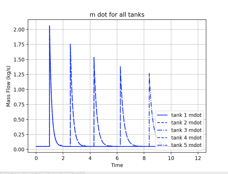

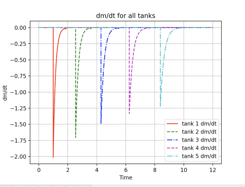

Chestermiller said:
It happens because the fluid is expanding from a liquid to a vapor. This causes all the liquid downstream to move with the same increased vapor velocity and mass flow rate. So the downstream liquid has a much greater mass flow rate than 0.05 kg/sec.
Ok so in tanks where there is evaporation taking place, we will have a mixture of liquid and vapour. The liquid will therefore travel at the faster velocity (the vapour velocity). As the liquid density is greater than the vapour density, this will result in an increase in the mass flow rate.
Question on that - why would the liquid take the same value as the velocity of the gas in the saturated zone, and not at an 'averaged' speed i.e. ##v_{mix} = (1-X)v_l + Xv_g##
Chestermiller said:
How do you think that affects the mass flow rates in and out of the tanks downstream of this? Doesn't it also cause them to have that same high value?
Hmm well yes if the mass flow out of the saturated zone is increased then you would expect this value to propagate downstream.
However I don't see why it would be increased in our case. I would have thought the mass flow would take on this higher value initially, and then actually decrease back down to a lower mass flow rate, because we've got a low density gas downstream of the saturated zone, and a high density liquid upstream. If the volumetric flow is constant across the bed, then surely the mass flow downstream of the saturated zone will be lower than the upstream flow rates, due to the lower density?
So what I thought was - in the saturated zone we would see a mass flow rate higher than the inlet liquid mass flow, and as evaporation takes place this mass flow rate would gradually decrease back down to the inlet flow, and possibly even lower due to the lower vapour density. Incorrect?

I think you have downstream and upstream switched. What does your model predict about ##\dot{m}## leaving the various tanks as a function of the tank number (i.e., spatially) at times when there is still pure liquid remaining in some of the (downstream) tanks?
  • #298
Apologies for the delay I found some script errors that I needed to fix.
And yes you were right I did have them switched. Ok yes now get the idea I think. The high speed gas upstream should 'push' the liquid downstream of it. The gas and liquid will have to travel at the same velocity, and therefore increase the mass flow rate of liquid to a value above 0.05kg/s, due to its higher density.
Here is what the spatial model predicts about ##\dot{m}##.
Flow exiting each tank as a function of time. I've used 5 tanks:
and dm/dt:
So I understand in theory how we would see an increased flow downstream of the saturation zone, but I don't understand how (or if) we have incorporated that properly in our model. I'll think about this.
I can clearly see though there is a spike in mass flow in each tank, and that spike gets progressively smaller as we move through the tanks. Hmm I guess this has to do with there being less liquid downstream in the later tanks, but again how we have incorporated that in the model I'm not sure. I will think about this before the morning
  • #299
View attachment 294928and dm/dt:
What does ##\dot{m}## vs tank number at various fixed times look like?
  • #300
Given the spikes in mass flow are narrow, its hard to pick suitable time intervals that show this. However, this is a plot of the first 11 seconds in intervals of 1 second:
Its a poor quality plot (as I say difficult to plot when the saturation last <1 second at each position), so I'm working on presenting this clearly.
But yes for now this shows that after 1 second the mass flow in the tank is at a maximum of 2kg/s (much larger than the inlet flow), and this value matches the previous plot of time vs flowrate.
Also at approx 3 seconds we can see from the previous plot the flow is almost 0.25kg/s around the middle to the end of the tank (still much larger than the inlet flow), and this matches the position vs flow plot also
So yes while this plot isn't great it does line top with the last one
