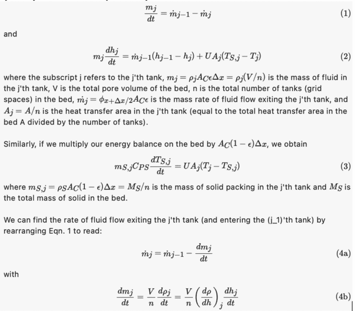

The parameter n is the total number of tanks being considered, not a counting index. The counting index “i” is 1 for the first tank, 2 for the second tank, and 3 for the 3rd tank. The location of the center of the i’th tank is at ##x=\frac{(2i-1)}{2}\Delta x##. The left side of the i'th tank is at ##x=(i-1)\Delta x##. The right side of the i'th tank is at ##x=i \Delta x##.
Understood now. I read the original comments you had deriving the spatial variation model and I follow now.
Ok then sounds like n=3 and I should run some diagnostics

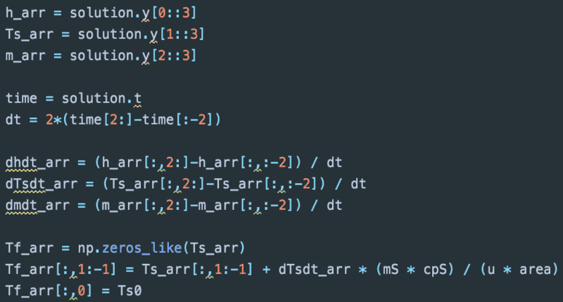

The differential equations all look ok to me, so I reckon the error is in how I have set up the initial and boundary conditions. Checking this now
I have a feeling that the thing that is causing your numerical problems is the overall mass balance for each tank.
Are you still using an automatic integrator, and calculating the time derivative of the entire solution vector all at once for the integrator to use? If so, do you have the solution vector as the column vector ordered as ##h_1,T_{S,1}, h_2, T_{S,2},h_3, T_{S,3},...##?
If you are using this scheme, you calculate the time derivative of ##h_1## for the first tank using ##\dot{m}_0## which does not change with time. Then you calculate ##\dot{m}_1## exiting tank 1 and entering tank 2 using the mass balance equation with the time derivative of ##h_1## that you just calculated for the first tank. Then you use this value of ##\dot{m}_1## entering tank 2 to calculate the time derivative of ##h_2## for the second tank. Then you calculate ##\dot{m}_2## exiting tank 2 and entering tank 3 using the mass balance equation with the time derivative of ##h_2## that you just calculated for the second tank. Then you use this value of ##\dot{m}_2## entering tank 3 to calculate the time derivative of ##h_3## for the third tank. etc. In the end, you will have all the time derivatives of the h's in all the tanks, which gets loaded into the time derivative vector. And, of course, in each of these steps you are also calculating the time derivative of the bed temperature for the specific tank, and also loading this into the derivative vector.
Is this what you are doing? If not, what is the scheme that you are applying?

Yes to all this, except the solution vector is ##h1,TS1,m1,etc## where m1 is the flowrate. The way I've set up the mass holdup and mass flow does look suspect to me. I don't think this affects the solution but I could remove this from the solution vector in case I'm doing something wrong there in the setup
Chestermiller said:
If you are using this scheme, you calculate the time derivative of h1 for the first tank using m˙0 which does not change with time. Then you calculate m˙1 exiting tank 1 and entering tank 2 using the mass balance equation with the time derivative of h1 that you just calculated for the first tank. Then you use this value of m˙1 entering tank 2 to calculate the time derivative of h2 for the second tank. Then you calculate m˙2 exiting tank 2 and entering tank 3 using the mass balance equation with the time derivative of h2 that you just calculated for the second tank. Then you use this value of m˙2 entering tank 3 to calculate the time derivative of h3 for the third tank. etc. In the end, you will have all the time derivatives of the h's in all the tanks, which gets loaded into the time derivative vector.
Yes to all of this, as far as I know I'm following this exact scheme unless the error is that I've coded this scheme incorrectly
Instead of this I'm just taking the solid energy balance, and generating the fluid temperature vector afterwards. The Ts array is known so I generate the dTs/dt array also and get the fluid temperature array from this. This image shows the flow for that:

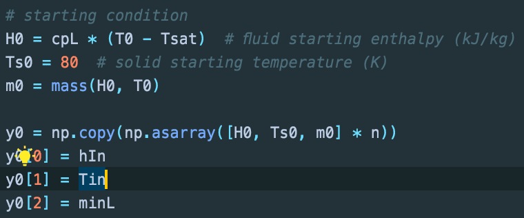

Python code snippet computing time derivatives with numpy: dhdt_arr, dTsdt_arr and dmdt_arr from central differences, and Tf_arr built from Ts_arr plus dTsdt_arr times (mS * cpS) divided by (u * area), with Tf_arr[:,0] set to Ts0.
I'll go for removing m from the solution array first

You are definitely not going to be integrating ##dm_i/dt## with respect to time. Once ##dh_i/dt## is known, ##dm_i/dt## can be evaluated and used to get ##\dot{m}_i## from $$\dot{m}_i=\dot{m}_{i-1}-\frac{dm_i}{dt}$$I guess that's what you do.

The fluid temperature and bed temperature must be solved simultaneously, not one and then the other.

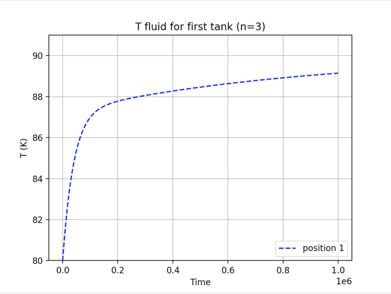

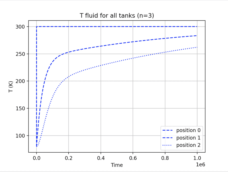

Got it. Its the way I'm regenerating the derivatives. Solved now!:
Line plot titled 'T fluid for first tank (n=3)' of fluid temperature T in kelvin against time up to 1e6, showing a dashed blue curve for position 1 rising sharply from 80 K then levelling off near 89 K.

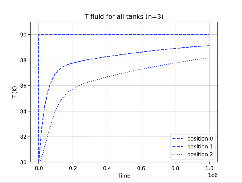

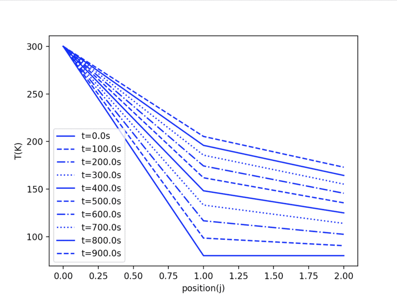

Excellent. Now how about plotting the temperature vs time for all three tanks, and also showing on the same plot the result from the single tank model for the overall bed.

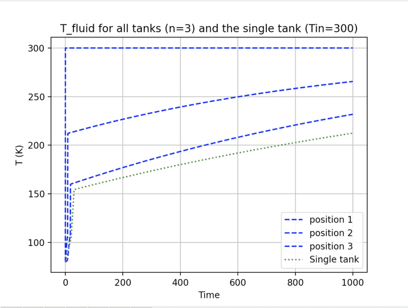

No. It is mathematically equivalent to the multi-tank model, and I was offering it as a simpler alternative to program. Now that the existing multi-tank model is working, it would only be redundant and unnecessary.
How about next doing the liquid-only calculation with many more tanks and doing the 3 tank version with the full temperature range with inlet at 300 K?
On this now
Got it so the first model just involves increasing n (to 32 for example)?

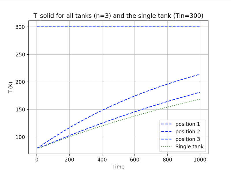

The second model just involves changing the inlet temperature to 300. Actually I will make another small change - right now I'm inefficiently manually calculating the inlet enthalpy so I'll just create a function for that
I'll try find a good way to blend plots from separate files into the same plot, because this sounds like something I'll need again (rather than going the other route of copying/pasting into the same file and changing variable names)

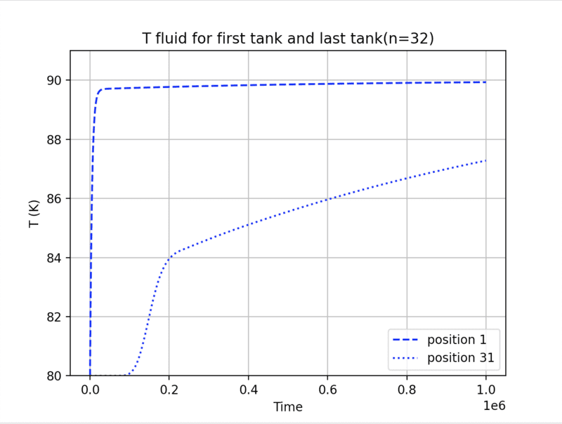

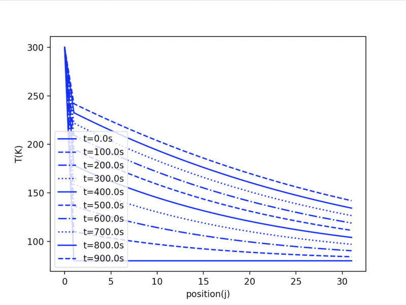

Got caught up with some report writing this evening. Back in action now

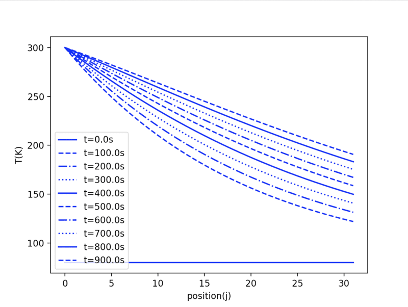

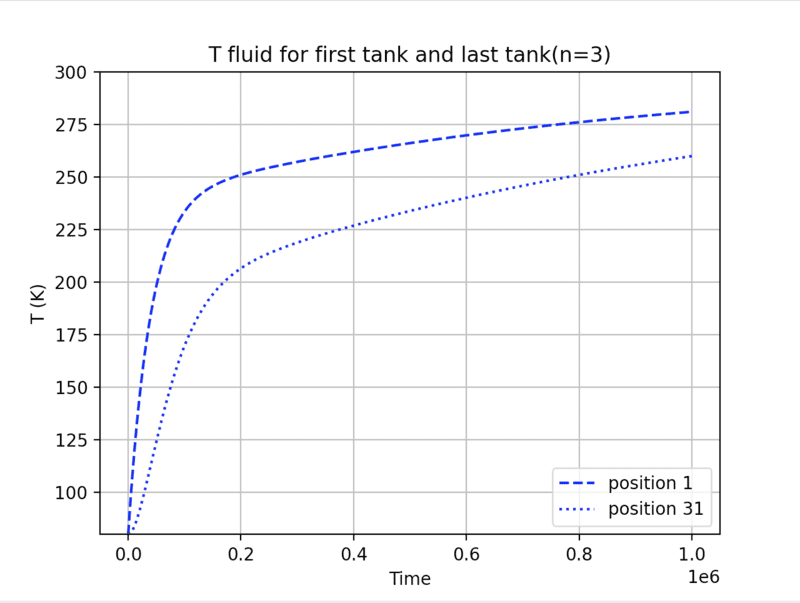

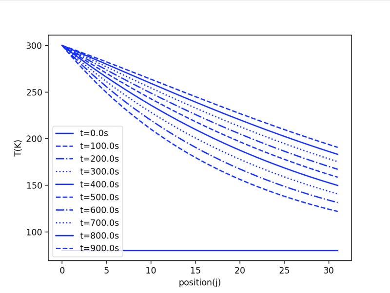

Heres the liquid-only plot with more tanks (n=32). Plotting the temperature profile for the first and last tank here:
Line graph of fluid temperature T (K) against time for the first and last of 32 tanks: position 1 rises sharply to about 89.7 K and then levels off near 89.9 K, while position 31 stays at 80 K until about 0.1 million, then rises to about 87.3 K at 1 million.

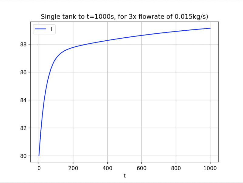

I checked this against the single tank plot for a 32x flowrate and they do match

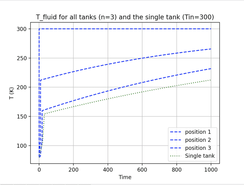

I was about to post and noticed this plot was incorrect. I took out some gas functionality to simplify the code so I could spot the error. Its a quick job to put this back in so I'll do this first thing tomorrow

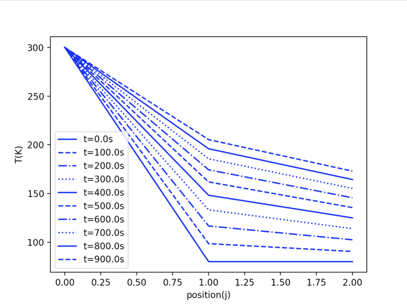

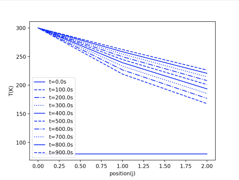

Looking into a good way to do this overlay plot still. For now here it is as two separate plots:

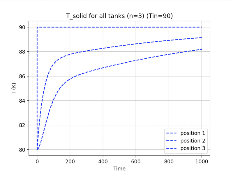

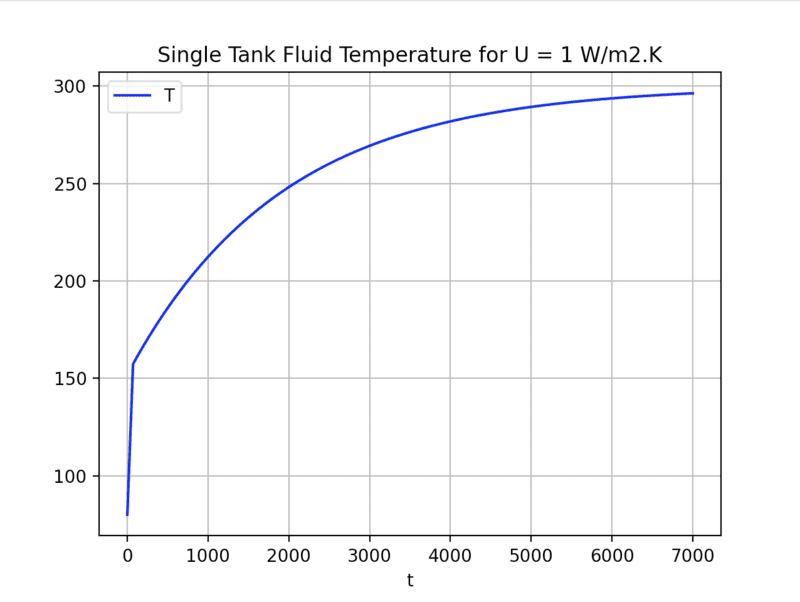

Temperature vs time for all three tanks (liquid phase only):
Line graph titled "T fluid for all tanks (n=3)" plotting T (K) from 80 to 90 against Time up to 1e6 for three positions: position 0 jumps to 90 K immediately, position 1 rises rapidly then slowly toward 89 K, and position 2 rises more slowly toward 88 K.

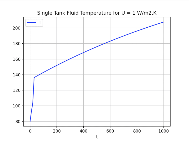

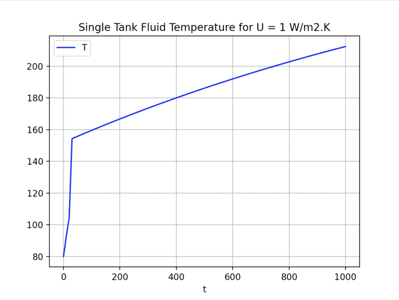

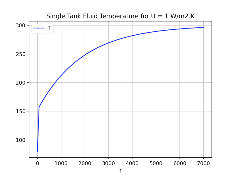

Line plot titled 'Single tank to t=1000s, for 3x flowrate of 0.015kg/s' showing T rising from 80 at t=0 steeply then levelling off, reaching about 89 at t=1000 s, with x-axis t and y-axis unlabelled numeric scale.
So now we seem to have a working model for a single and multi-tank setup. I can think roughly about what the future models would hopefully look like, however to get there, what do you think are the next best steps?
So some simplifications we've made:
- The enthalpy/mass holdup relations. In previous posts you mentioned we would stick to correlations like these. If its an option then we can also use H(T,P) methods already made in other Python libraries i.e. just use a property calculation library to calculate enthalpy
- The heat of vaporisation. Right now we're leaving this as a constant. I have methods again from thermo libraries that treat this as a function of temperatures so we have the option to use this
- The saturation conditions. Right now we've got Tsat defined at the top as a constant. I have Tsat(P) functionality so I could use this no bother to get the saturation temperature
- The quality. Right now we get around the quality with the saturation zone relations
- The fluid. So assuming a pure fluid let's us have one saturation temperature. Air is a mixture so we'll have a bubble/dew point. This definitely sounds difficult to implement. That said I have a lot of useful functionality from the thermo property libraries like dew/bubble point temperature calculations for mixtures, Pressure-Enthalpy flash functionality, really anything we would need. So the important bit here is the actual algorithm, the functionality is available
- Lastly obviously we have constant heat capacity, etc. This can easily be switched out for temperature/pressure dependent values later on but yes its probably best to leave them as constant for now to avoid cluttering etc
- The U value. I've put a value of 1 (out of thin air). We could improve on that
From the above it seems that it might be best to stick with a pure fluid until we get to a late stage model, and then switch to a mixture. Developing the pure fluid model to late-stage would also give us the ability to test pure fluids in the packed bed
So yes, in terms of the next step or two, what do you think is best?

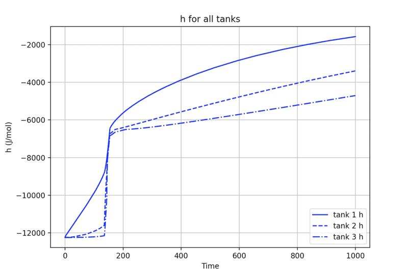

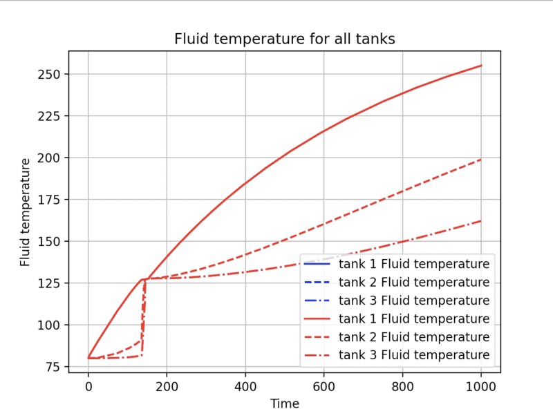

  • Line graph titled "T fluid for all tanks (n=3)" plotting T (K) against Time from 0 to 1e6, with three blue curves: position 0 stays flat at 300 K, position 1 rises from about 80 K to about 283 K, and position 2 rises from about 80 K to about 262 K.
  • Line graph titled "T fluid for all tanks (n=3)" plotting T (K) from 80 to 90 against Time up to 1e6. Position 0 jumps to 90 K immediately and stays flat. Positions 1 and 2 rise from 80 K toward about 89 K and 88 K respectively, with position 1 always above position 2.
  • Line graph of fluid temperature T (K) against Time from 0 to 1e6, with two dashed and dotted blue curves: position 1 rises steeply to about 280 K, position 31 rises more slowly to about 260 K.
What happened to tank 32? This seems to be only tanks 1 and 31.

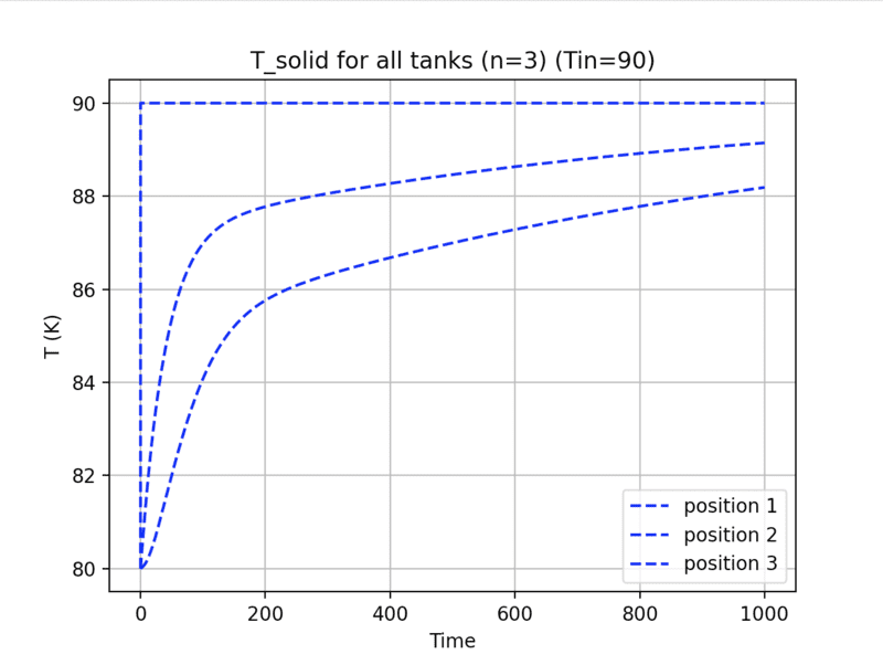

What happened to the 3rd tank? This looks like only tanks 1 and 2. Also, I was hoping you would show on this same plot for comparison the results from the single tank model for 1X the throughput rate.

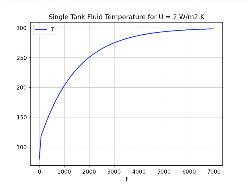

From the results so far, my guess is that UA is much higher than we are using.

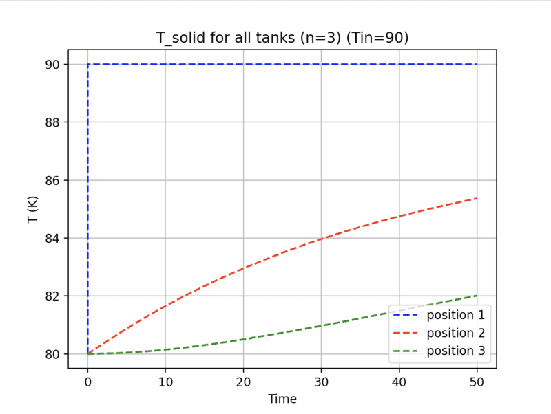

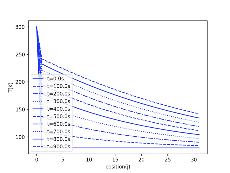

I agree. I would like to see you put the pure fluid model through its paces. Things I suggest are,
1. in addition to temperature vs time at the various spatial positions, also prepare plots of temperature vs position at a selection of times. The latter will illustrate how the wave is traveling through the bed.
2. corresponding plots for the solid bed
3. Varying the parameters for the model like mass flow rate to the bed and UA (higher UA would be particularly interesting)

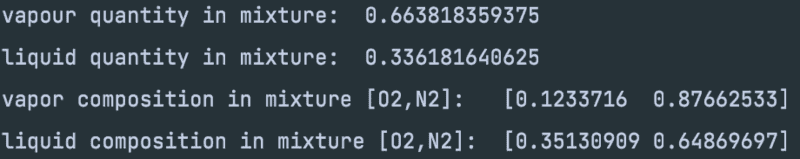

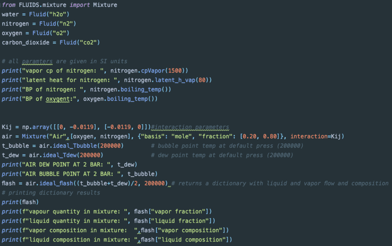

Here is a calculation that I would like to see you do to get your feet wet on the mixture model: I have 1 mole of air (80% nitrogen, 20% oxygen) at 2 bars. What is the dew point and what is the bubble point? At a temperature half-way between the dew point and bubble point, what is the molar split of liquid and vapor, the mole fractions in the liquid phase, the mole fractions in the vapor phase, the density of the liquid phase, and the density of the vapor phase?
Yes because its zero indexed its ##tank number = position number +1## so that is tank 32 and tank 3 respectively

Working on a function to merge two plots now. Ok so we're saying the 3 tank plot for 0.05kg/s and the single tank plot for 0.05kg/s on the same plot? So we're expecting the last tank of the three tank plot should match the single tank plot
Yes.
Not exactly. There should be some similarities, although the 1 tank is inherently more disperse than the 3rd tank of the three tank.

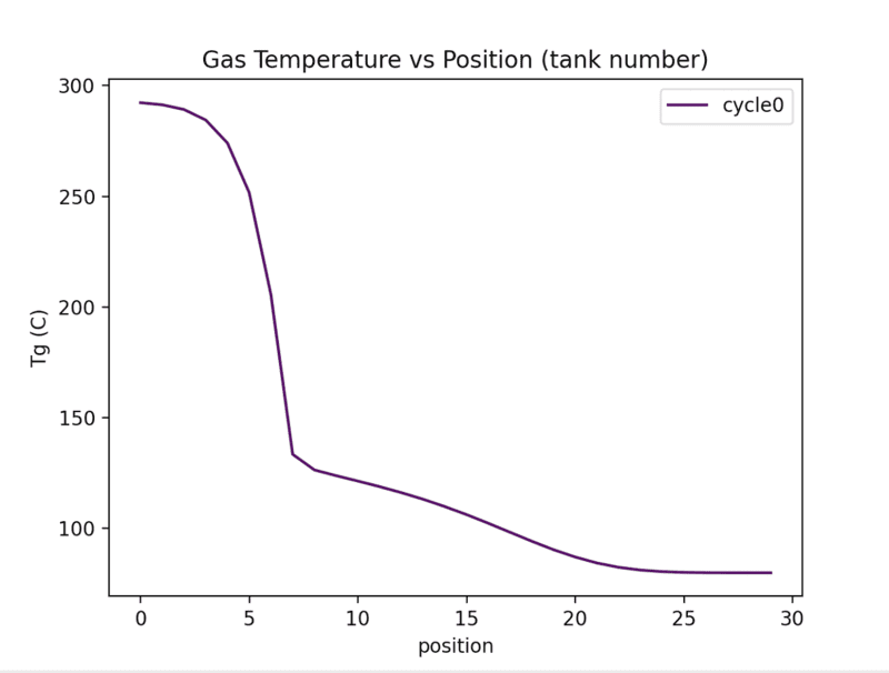

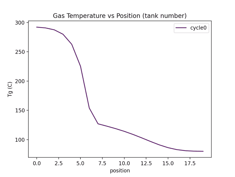

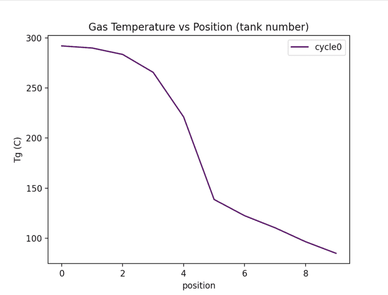

Three tank plot for 0.05kg/s and single tank plot for 0.05kg/s:
Line plot titled 'T_fluid for all tanks (n=3) and the single tank (Tin=300)': fluid temperature T (K) against time for three tanks (position 1, 2, 3, dashed blue) and a single tank (dotted green), all rising from about 80 K toward 300 K over time.
Fluid temperature versus position for a range of times (0,200,400,600,800,1000):
Line plot of T(K) against position(j) from 0.00 to 2.00 for ten times from t=0.0s to t=900.0s, with temperature falling from 300 K toward about 170 to 230 K; a flat line near 80 K is also shown.
Solid temperature versus position for a range of times (0,200,400,600,800,1000):
Line plot of T(K) against position(j) from 0.00 to 2.00 for ten times from t=0.0s to t=900.0s, showing temperature falling from 300 K at position 0 with a steeper drop to about 80 to 205 K at position 1.
The above are for n=3. Might be more visually interesting to see more spatial plots, so the same plots for n=32:
Fluid:
Line plot of T(K) against position(j) from 0 to about 31, with ten curves at t = 0 to 900 s in 100 s steps; temperature falls from 300 K to about 80 K, and the lowest curve is flat at about 80 K.
Solid:
Line plot of temperature T(K) against position(j) for ten times from t=0.0s to t=900.0s, showing temperature falling steeply near position 0 and decreasing more gently toward position 30.
Note: The time for the n=32 simulations to run to completion is about 2 minutes
  • Line graph titled "Single Tank Fluid Temperature for U = 1 W/m2.K" showing T rising steeply from about 80 at t=0 to about 157 near t=50, then rising more slowly and levelling off near 296 by t=7000, with axes t and T.
  • Line graph titled 'Single Tank Fluid Temperature for U = 1 W/m2.K' plotting T against t from 0 to 1000; temperature rises steeply from about 80 to about 136 by t≈30, then climbs more slowly to about 207 at t=1000.
  • Line plot titled 'Single Tank Fluid Temperature for U = 1 W/m2.K', with temperature T on the vertical axis (80 to 200) against t on the horizontal axis (0 to 1000). The curve rises steeply at first, then more gradually.

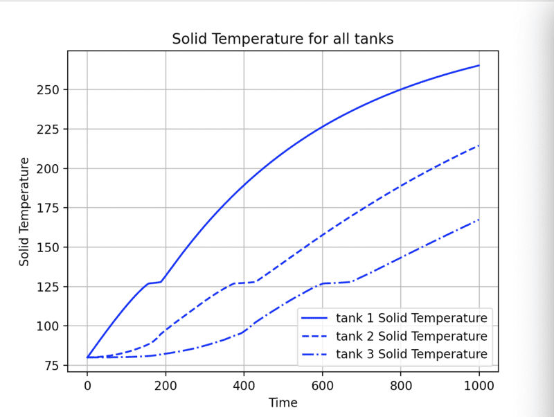

  • Line graph of solid temperature T (K) against time for three tank positions and a single tank, with Tin = 300 K; position 1 stays at 300 K while the others rise from about 80 K to between roughly 170 and 215 K by time 1000.
  • Line plot of solid temperature T (K) against time for position 1, position 2, position 3 and a single tank; position 1 stays at 300 K while the others rise from about 80 K to between 170 and 215 K by time 1000.

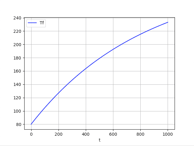

Hmm there is some code editing required to run a range of UA values. What I'll do for now is plot U = 1, 1.5 and 2 for the single tank:
Line graph of fluid temperature T against t for a single tank with U = 1 W/m2.K, rising from about 80 at t = 0 to about 296 near t = 7000.
Line plot of single tank fluid temperature T against t for U = 2 W/m2.K: T rises from about 80 at t=0, steeply to about 130, then flattens towards about 298 by t=7000.
Line graph titled 'Single Tank Fluid Temperature for U = 3 W/m2.K', plotting T against t from 0 to about 7000: T rises steeply from about 80 to about 118, then climbs more slowly, levelling off near 298 by t = 7000.
Setting up the code for the bubble/dew point/mole fraction calculation now
Edit: These UA plots don't make much sense to me yet. I thought increasing U would decrease the time required to reach 300K. So I need to think about this a bit
Fluid:
Solid:
I still have a problem with tank 1 in these which seems to show an instantaneous response of the temperature to the inlet temperature. It seems to me that this is just the inlet temperature to the bed. This part of the results just doesn't seem right to me. Maybe you can show the comparison for the liquid-only model for these same cases?
I agree here maybe by inlet conditions for the gas setup (300K) are incorrect

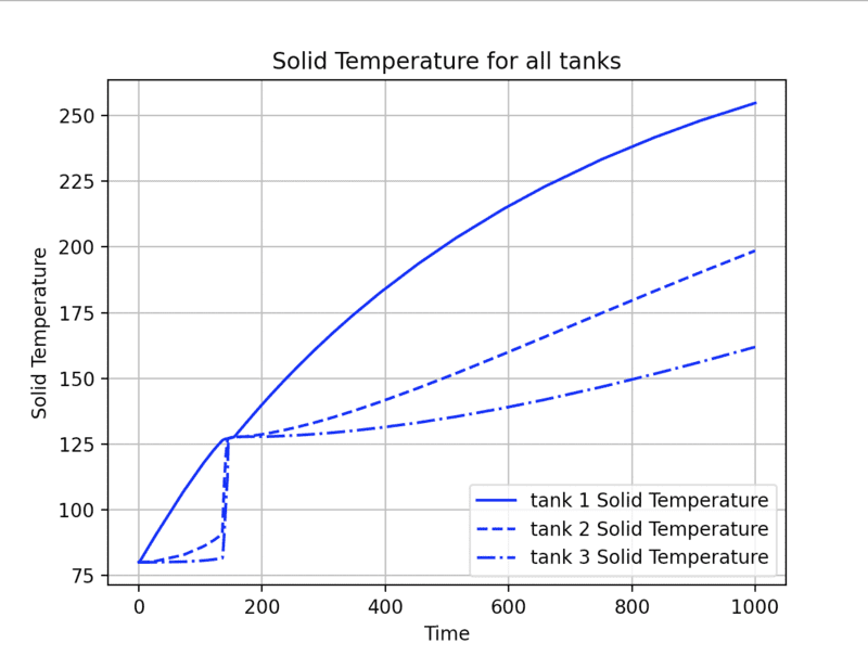

Liquid plot for n=3. I thought the initial conditions might have been set up correctly but no, at position 1 (index 0) the initial temperature is 80 and it rapidly rises to 90K (similar behaviour in the gas plot)
Line graph titled 'T_solid for all tanks (n=3) (Tin=90)' of T (K) against Time from 0 to 1000. Three dashed blue curves: position 1 is flat at 90 K after a vertical drop from 80 K; positions 2 and 3 start at 80 K and rise toward about 89 K and 88 K.
The notation on the graph above is poor. 'Position 1' is at index 0. Position 1 is where the boundary conditions are applied. The way the code is set up, the bed/fluid temperatures for the entire bed are both set to 80K, and then the first position only is overwritten, and this is the boundary condition:
Code editor screenshot of Python lines setting starting conditions: H0 = cpL * (T0 - Tsat) fluid enthalpy, Ts0 = 80 solid temperature, m0 = mass(H0, T0), and y0 = np.copy(np.asarray([H0, Ts0, m0] * n)), followed by y0[0] = hIn, y0[1] = Tin, y0[2] = minL.
So using that approach it is expected that the index 0 position would go straight to the inlet fluid temperature. It does this in the model that matches the analytical solution also
Because it matches the analytical solution for the single tank, I think this seems ok
  • Line graph titled T_solid for all tanks (n=3) (Tin=90), plotting T (K) against Time for three positions: position 1 jumps from 80 to 90 at time 0 and stays flat; position 2 rises gradually from 80 toward about 85.4; position 3 rises slowly from 80 to about 82.
Python code screenshot importing Mixture from FLUIDS, defining water, nitrogen, oxygen and carbon dioxide fluids, an interaction array Kij, an air mixture of 20% oxygen and 80% nitrogen by mole fraction, bubble and dew point temperatures at 200000 Pa, and a flash calculation printing vapour and liquid fractions and compositions.
Here is a rough solution to the calculation you mentioned above. The code should be fairly readable. You can see the Mixture setup about half way down, where the components and the mole fractions are defined. From there once we have the mixture defined there are bubble and dew point methods, and a flash method to get the liquid/vapour fractions and compositions.
One note here is that this is an ideal flash calculation. I do have the functionality for non-ideal flash. Its in another Github repository so I need to do some file moving to get it. This also has density methods for the liquid and vapour phases (or anything else we would need). For now here are some preliminary results from he above simulation:
Terminal output listing air dew point at 2 bar as 88.1496170753748 K and air bubble point at 2 bar as 85.16901586630381 K.
Console output of a flash calculation: vapour quantity 0.663818359375, liquid quantity 0.336181640625, vapor composition [O2, N2] [0.1233716 0.87662533], liquid composition [O2, N2] [0.35130909 0.64869697].
I'm totally confused about this. Are you saying that the overwrite the results for the first tank with the inlet condition, so it is not really the temperature vs time of the material in the first tank? If so, we never get to see the temperature vs time for the first tank? What about the subsequent tanks, are they somehow overwritten too? Why do you overwrite the first tank? That is of much more interest than the inlet condition. If this is what you do, please undo it.
Does the flash calculation assume constant enthalpy? if so, the temperature changes, right? What is the final temperature. I was hoping for a hand calculation on your part. Do you know how to set up the equations for such a hand calculation, assuming ideal mixing and ideal gas behavior?
Line graph titled 'T fluid for all tanks (n=3)' plotting T (K) from about 80 to 89 against Time from 0 to 1000 for three positions; all curves rise and level off, with position 0 highest, then position 1, then position 2.
There we go. You were right the results for tank 1 were being overwritten by the initial conditions. Obvious mistake looking back. The highest graph now shows the actual behaviour in tank 1, rather than the initial conditions.
I don't know actually. I took a look at the calculation (in code form) and its not clear to me. Yes I agree a hand calculation for the ideal flash would be useful to get a grip on how it works. I don't know how to set up the equations for this, I can figure this out though
After that hand calculation I'll redo the code with the real flash (and real mixture) methods. I guess this would be too involved to do by hand, however knowing how ideal flash works will give some insight into real flash calculations

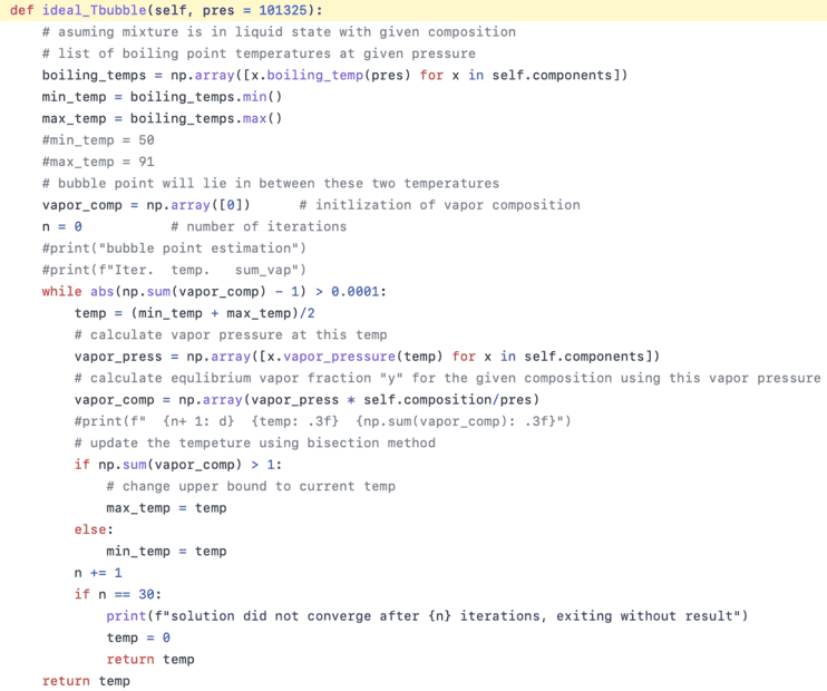

The bubble/dew point:
So we can use the Antoine equation and Raoult's law iteratively (bisection method) here to solve for both the de and bubble point temperatures
Algorithm for this could be as follows:
1) Set a temperature range that will capture the dew/bubble points (the boiling points of N2 and O2 at 2 bar for example)
2) Calculate the vapour pressure of N2 and O2 with the Antoine equation (using temperature)
3) Calculate the vapour composition of both components using Raoult's law
4) Sum both vapour compositions (O2+N2)
For the bubble point: Depending on if the sum of the vapour compositions is greater than or less than 1, update the temperature bounds accordingly and repeat
For the dew point: Depending on if the sum of the vapour compositions is greater than or less than 1, update the temperature bounds accordingly and repeat
Now that I follow the algorithm, this is the algorithms in code (I don't think there's value in writing this out):
Python function ideal_Tbubble that estimates the bubble point temperature by bisection, bounding temperature between the minimum and maximum component boiling points and stopping when the vapour composition sum is within 0.0001 of 1.
Air dew and bubble point temperatures at 2 bar:
Program output lines: AIR DEW POINT AT 2 BAR (K): 88.1496170753748 and AIR BUBBLE POINT AT 2 BAR (K): 85.16901586630381
