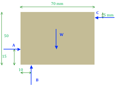

The board shown below is being held in equilibrium in the vertical plane by three smooth rods at A, B, and C
Determine the magnitudes of forces at A, B, and C in terms of the weight of the body, W.
Moment = f*r
Here's a diagram
I'm assuming the point of rotation is in the middle, at 'W'
So, B will be 25mm away, pushing clockwise
A, 10 mm away pushing clockwise
C 20 mm away pushing CCW.
I don't exactly get what they mean by 'In terms of the weight of the body 'W'" , because W is outside of the input section, and it only accepts numbers into the blank. Thank you.

The forces that must be applied at A, B, and C will depend upon the weight of the board, W. So presumably you are expected to answer in terms of some numerical value times W.
