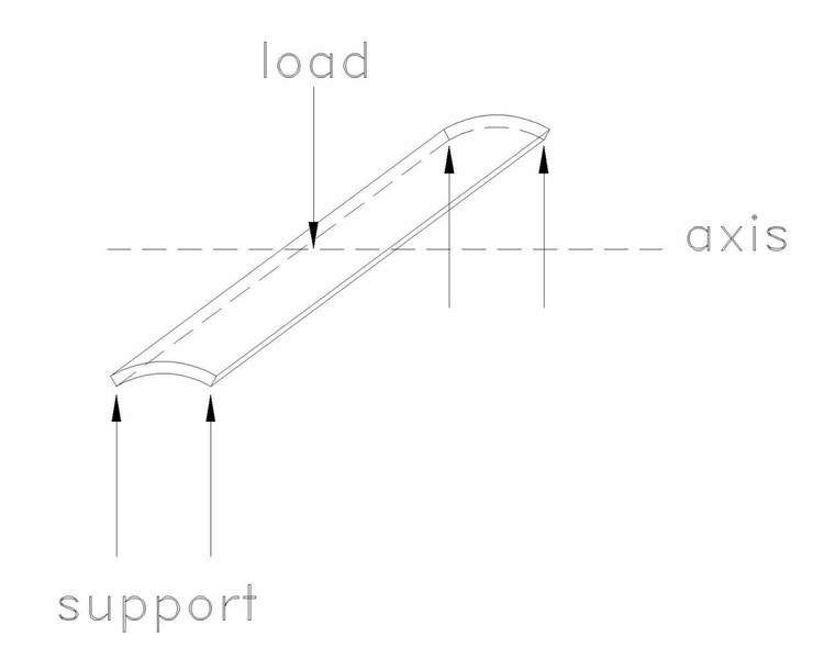

I am trying to calculate the moment of inertia of a formed (uniform curve) flat bar. I have attached a sketch . The bar is 5/8" thick x 1" wide. I'm stumped.

Is this a homework problem where you need to come up with the derivation?
Roark's Formulas for Stress and Strain has the answer to that exact section, in Appendix A, Table A.1 (Properties of Sections).
Thanks for the fast reply. Exactly what I needed. My 5th Edition Roark lacks the appendix!
I have the Seventh edition and it has it, and from what I can tell the Sixth edition has it as well. Time to get a new Roark's!

is this a thick or a thin section? With some calculus we can figure out what will be the moment of inertia..
If your looking for an exact answer you would have integrate it using:
Ixy=∫xydA since it is curved
Honestly though I would just get a rough estimate with a simple rectangular cross-section area moment of inertia equation
I=1/12bh^3
or I would use a program like Solidworks that would calculate it for me.
