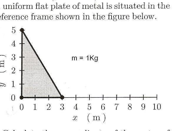

in my homework the question wants from me to find the moment of inertia of
right triangle with the y-axis
as shown in the attatchment
note: the mass of the plate is 1 kg
i found the y coordinate of the center of mass of the plate it is 5/3
and i supposed it is the r
so the inertia will be mr^2
=1*(5/3)^2
=25/9
=2.77777 kg m^2
is that right??

If you're calculating the moment of inertia with respect to the y-axis, then it doesn't look right.
Thank you >
but Why??
can you give me a hint??
I think it would be better for you to show us how you found that. Also, why do you suppose it is "the r"?
i found it from the first part of the question
Now that you found it, please post it.
