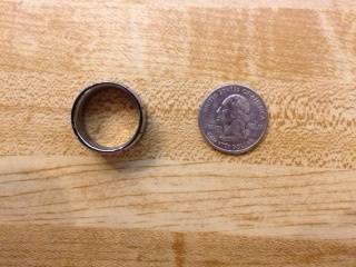

Photo shows a ring and a disk. Both have mass.
Is it the amount of mass then? For instance, a ring would begin moving faster than a disk if pushed, assuming no outside forces acted on it...
