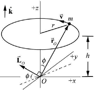

Suppose there is a point mass performing circular motion about an axis shown below:
https://drive.google.com/file/d/0B36r-g6bshskV2hIcl91aXl4ZzA/edit?usp=sharing
If the angular momentum is taken about the origin O, then the angular momentum L is not parallel to the axis of rotation. As the mass is moving in the circular orbit a torque is needed because L is keep on changing direction.
However, if the angular momentum is taken about the center of circular motion, then L is always parallel to the axis of rotation and no torque is needed to maintain the circular motion.
How to solve this paradox?
  • Diagram of a point mass m moving in a horizontal circle of radius r at height h above the origin O, with velocity v tangent to the circle, position vector r_O from O, angle phi between r_O and the +z axis, and angular momentum L_O shown at O.
There is no paradox. Torque about origin is non-zero and about the center is zero.

Thanks all. It's clear now. Since the perpendicular distance between the original center of circular motion and the vector V is always the same, mrxv is kept constant while the mass moves linearly after the centripetal force is removed.
For a point mass, to conserve angular momentum it doesn't spin (and it cannot) and simply move forward.
For a sphere that always has the same point facing the center O during circular motion, after the centripetal force is removed it spins with same self spinning angular speed as before. It also has linear motion which its center of mass moves like the case of point mass.
