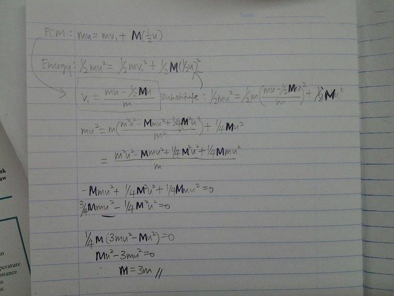

2. (This is a supplementary question :blushing:) The yellow star question in image 2. My workings in image 3. Is there any shorter solution?
Your solution looks good. I don't think there's a shorter way. I would have done the same.
