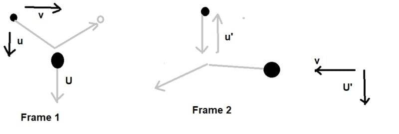

  • Two-frame diagram of a collision: in Frame 1 a small mass with velocity u and a large mass with velocity U meet, with arrows for u, U and v; in Frame 2 the velocities are u' and U' with the frame velocity v shown.

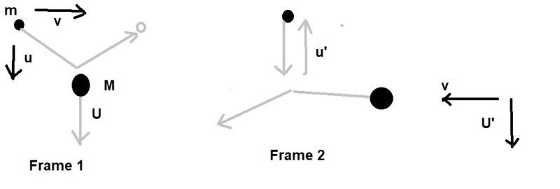

  • Two-frame diagram of a collision: in Frame 1 a small mass m moves right with velocity v and down with u, a large mass M sits below with velocity U; in Frame 2 small mass moves with u' and large mass with velocity v and U' with arrows showing directions.

Here's a derivation of the relativistic form of momentum under a few assumptions about momentum:
  1. Momentum is proportional to the mass of the object.
  2. Momentum is in the same direction as the velocity.
  3. The magnitude of the momentum depends only on the magnitude of the object's velocity (not its direction)
This implies that ##\overrightarrow{p} = m f(v) \overrightarrow{v}## for some unknown function ##f(v)## that depends on the magnitude of the velocity. To have the correct nonrelativistic limit, ##f(v) \rightarrow 1## as ##v \rightarrow 0##.
I'm also going to assume a few things about elastic collisions between spherical masses
  1. In an elastic collision between a small mass ##m## and a much larger mass ##M##, the direction of the velocity of the smaller mass changes, but not its magnitude (think of a ball bouncing off a brick wall). (Of course, this won't be precisely true, but will be true in the limit as ##m/M \rightarrow 0##
  2. In an elastic collision between spherical objects, the momentum changes along the axis connecting their centers, but not in the orthogonal direction.
These assumptions are illustrated by the following picture:
Diagram of an elastic collision: a small black mass m moves down-right toward a large black mass M, then rebounds up-right while M moves straight down with velocity U; a grey circle marks the outgoing position, labelled v (rightward) and u (downward) in the corner.
The small mass is initially traveling with a velocity of ##v## in the x-direction, and a velocity of ##-u## in the y-direction. Initially, the large mass is stationary. After the collision, the small mass just flips its velocity in the y-direction, and the velocity in the x-direction remains unchanged. (This is only true in the limit as ##m/M \rightarrow 0##. So the following is only approximate reasoning).
We assume that ##v## is relativistic, while ##u \ll c## and ##U \ll c##.
Our assumption about momentum is that ##\overrightarrow{p} = m f(|\overrightarrow{v}|) \overrightarrow{v}##.
So for the small mass, ##v^x = v##, ##v^y = -u## and ##|\overrightarrow{v}| = \sqrt{v^2 + u^2} = v + \frac{u^2}{2v} + ...## (expanding the square root using a Taylor series). Since ##u \ll v##, we find that ##|\overrightarrow{v}| \approx v## (ignoring smaller terms).
So the momentum in the x-direction is ##m f(v) v##, and the momentum in the y-direction is ##-m f(v) u##. After the collision, the momentum in the x-direction remains unchanged and the momentum in the y-direction reverses, to ##+m f(v) u##.
For the large mass, initially it is at rest. After the collision, we're assuming that it's moving nonrelativistically, so its momentum is just ##-MU##.
Using conservation of momentum in the y-direction, we find approximately: ##-m f(v) u = +m f(v) u - M U##. So we have one equation:
##MU = 2m u f(v)##

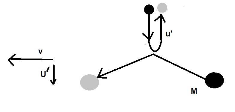

Now, let's switch to the rest frame that is moving at velocity ##v## relative to the original rest frame. In this frame, we have the following picture:
Hand-drawn diagram of an elastic collision: a small grey-and-black ball travels down onto a large black mass M, bounces off the contact point, and leaves with velocity components labelled v (leftward) and U' (downward).
In this frame, the small mass has no velocity in the x-direction. In the y-direction it has velocity ##-u'## before the collision, and ##+u'## after the collision. ##u'## is nonrelativistic, so we can use, approximately, ##p = - m u'## in the y-direction.
The large mass is initially moving at velocity ##-v## in the x-direction. After the collision, it is moving with a small velocity ##-U'## in the y-direction, as well. As before, we can write, approximately, the momentum in the y-direction after the collision as ##-M f(v) U'##.
Using conservation of momentum in the y-direction in this frame, we get:
##-m u' = +m u' - M f(v) U'##
So:
##M U' f(v) = 2m u'##
Now, divide by ##MU = 2m u f(v)##, our earlier equation, to get:
##\frac{U'}{U} f(v) = \frac{u'}{f(v) u}##
Rearrange that to get:
##(f(v))^2 = \frac{u'}{u} \frac{U}{U'}##
Okay, finally we use the relativistic velocity transformation formuas: For a Lorentz transformation in the x-direction, the y-component of velocity transforms as follows:
##(V^y)' = \frac{1}{\gamma} \frac{V^y}{1 - \frac{(V^x)^2}{c^2}}##
So for the small mass, in the first frame, originally ##V^x = v## and ##V^y = -u##. So in the second frame, ##u' = \frac{1}{\gamma} \frac{-u}{1-\frac{v^2}{c^2}} = -\gamma u##. So ##\frac{u'}{u} = \gamma##.
For the large mass, in the first frame, after the collision, ##V^x = 0## and ##V^y = -u##. So in the second frame, ##U' = - \frac{1}{\gamma} U##. So ##\frac{U}{U'} = \gamma##.
Plugging these into the equation for ##f(v)## gives:
##(f(v))^2 = \frac{u'}{u} \frac{U}{U'} = \gamma^2##
So ##f(v) = \gamma##.
That's the only choice that respects the relativistic velocity addition formula (and the other assumptions I gave at the top).
