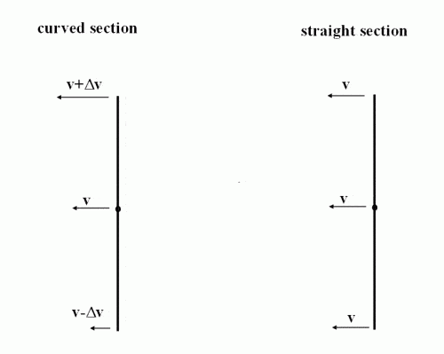

The case of a rolling cylinder is very different from the present one: as the third of your references makes it very clear (p.17), the constraint for the rolling cylinder is only caused by the friction force. You can actually consider an equivalent setup to the present here: assume a cylinder that is first sliding (not rotating) over a smooth surface, but suddenly the surface changes to a rough one. Now there will be a friction force that a) slows down the velocity of the center of mass and b) sets the cylinder in rotation due the torque involved. A steady state is only reached when the velocity at the contact point reaches zero (i.e. when the friction forces reaches zero and the cylinder is properly rolling). The crucial point is that for the sliding/rolling cylinder the friction force is directed parallel to the initial velocity i.e. parallel to the constrained path. In our case however there is, by assumption, no friction force. The only force is the centripetal force that keeps the rod on the rail in the shown configuration, but that force is strictly radial and has no components parallel to the rail i.e. can not do any work on the rod and thus not change its speed.

I looked at your 2 first references. They talk about other problem: a spinning body that has also transversal movement. This is not the case.
This is the same case. The center of mass is translating and the object is rotating about the center of mass. I don't know what you think makes it different. You must be focusing on some irrelevant aspect to conclude that it isn't the same. However, the point is that all three (and every other reference on the subject) clearly agree that you have to include both the translational and rotational KE.
In any case, it is a rather easy exercise to check. You can simply evaluate the KE of each differential element of the rod and see what you get.
[tex]KE = \int_M \frac{1}{2} v^2 \; dm[/tex]
[tex]KE = \int^{R+L/2}_{R-L/2} \frac{1}{2} v^2 \frac{m}{L} \; dr[/tex]
[tex]KE = \int^{R+L/2}_{R-L/2} \frac{1}{2} r^2 \omega^2 \frac{m}{L} \; dr[/tex]
[tex]KE = \frac{1}{2} m R^2 \omega^2 + \frac{1}{24} L^2 m\omega^2[/tex]
[tex]KE = \frac{1}{2} m v^2 + \frac{1}{2} I \omega^2[/tex]
Just as I said above and as confirmed by all of the references I provided. You must include both the KE of the translation of the center of mass as well as the KE of the rotation about the center of mass.

The presence or absence of any other force only determines whether or not KE is conserved, or if KE is converted to some other form of energy. It does not alter the correct expression for the KE.

  • #46
DaleSpam said:
There is no doubt whatsoever that the formula I provided above for the KE is the correct formula for the problem as stated.
Maybe for the problem of the rolling cylinder, but the present case is distinctly different. I have created another graphic to illustrate this: if you take the path along the rail as a generalized coordinate s and plot the vertical distance z of both ends of the rod from this path against this, you get parallel lines i.e. there is no motion of any part of the rod in a dimension orthogonal to the path s, so there is no kinetic energy apart from the translational kinetic energy along the path s. The system has only 1 degree of freedom because of the constraint.
In contrast, for the rolling cylinder, there is an oscillatory motion in the z-direction, so there a 2 degrees of freedom (even though they are coupled).
DaleSpam said:
No, that is not the only force. There is also a force which generates the torque to keep the rod oriented perpendicular to the rail.
A torque around the center of mass doesn't change the linear momentum of the latter.
To shed more light on the problem, one could consider an extension of the present thought experiment: assume in the curved section there is a point mass (same mass as the rod) at rest on the rail also constrained to move along the rail only. Assuming a totally elastic central collision of the two objects, what will happen if the rod hits the mass with velocity v? What will the velocities of the point mass and the rod along the rail be after the collision?
It isn't different. This isn't an assumption I am making. This is an obvious fact that I clearly derived in post 33.
So what? What has any of that got to do with the expression for the KE? Do you believe that the expression for KE is automatically ##\frac{1}{2}m \dot q^2## for any generalized coordinate, q?

DaleSpam said:
Your graphical illustration is irrelevant. For any rigid object you can always easily find generalized coordinates where the object is stationary in those coordinates.
So the fact that the plot of the generalized coordinates matches your illustration is completely uninformative. Any rigid body in any scenario undergoing any possible motion can match your illustration for some suitable choice of generalized coordinates.
You make it sound as if I had plucked the general coordinate out of thin air. It strictly relates to the physical constraint here. The rail and rigidly connected rod nail down the path of any mass element of the rod to be a curve parallel to the rail. So taking the general coordinate as the path along the rail is not only the natural thing to do here but even what you should do unless you want to get into difficulties.
DaleSpam said:
Therefore, you have to derive the expression for the KE in the generalized coordinates some other way. For this problem, I showed how in 5 and again in 33.
You have assumed a rotational degree of freedom that simply isn't there. 'Degree of freedom' means just that: the object is free to move in this dimension. But in this case it isn't because of the constraint. You can't rotate the rod without translating it. The system has only 1 degree of freedom. The rod may get rotated but it is not rotating. If you assume it is rotating you count something twice here.
DaleSpam said:
I fail to see the relevance of this new scenario to the scenario of the OP. You keep on bringing in irrelevant side issues. I don't know why.
It is not irrelevant. An elastic collision can conveniently separate the linear momentum from the rotational momentum. If you assume the rod with linear momentum p hits elastically a point mass with the same mass at rest on the rail, the conservation laws for the linear momentum and kinetic energy require that after the collision
1) the point mass has linear momentum p
2) the rod has linear momentum 0
But because the orientation of the rod is constrained to its linear motion, 2) implies also
3) the rod has intrinsic angular momentum 0
So since the total energy is p^2/2m after the collision, energy conservation requires that it is also p^2/2m before the collision, i.e. there was no intrinsic rotational energy of the rod present in the first place.
  • #57
Fantasist said:
Your suggestion was that the force of constraint changes the dynamics of the mass moving on the rail. This is impossible according to d'Alembert's principle. The force of constraint can't do any work. It just constrains.
I agree fully with d'Alembert's principle. The KE is conserved, therefore the constraint force does no work.
Your suggestion is the one which violates d'Alembert's principle since you would have the constraint do work to increase the KE around the bend so that the COM velocity is unchanged.
I agree that your s is a very natural coordinate, but that is not relevant to the argument. The naturalness of the coordinate is not in discussion, only the expression for the KE in terms of the coordinate.
Again, completely irrelevant. It doesn't matter if it is free to rotate or constrained to rotate. Either way it undergoes rotational motion wrt any inertial coordinate system and therefore has rotational KE. Remember, s is a generalized coordinate not an inertial coordinate. So you cannot simply assume that pure translation wrt s implies an absence of rotation wrt inertial coordinates.
My derivation in 33 starts with the known expression for KE in an inertial coordinate system and then calculates the expression in the generalized coordinates. If you disagree with my conclusion then please point out the exact step where I made my mistake.
Momentum isn't conserved in this problem, just energy. Again, I fail to see the relevance, but if you wish to work the problem, please be my guest. I gave instructions for doing so previously.
  • #58
The mistake is in your last step
where effectively you dropped the constraint.
Note that in the first equation the same angular frequency [itex]\omega[/itex] appears in both terms, which means that if one term gets larger (due to an increase of [itex]\omega[/itex]), the other would have to get larger as well, so it would violate energy conservation. Your final equation just hides this fact and pretends that you can compensate the increase/decrease of one term by correspondingly adjusting the other. This would be justified if you had actually two degrees of freedom (e.g. if the rod would only accidentally have a synchronous rotation) but not if the orientation is rigidly fixed relatively to the path.
  • #59
This does not change the validity of the equations.
2x=2x remains true even if I define y=x and replace it to get 2x=x+y as modified equation.
Note that in the first equation the same angular frequency ω appears in both terms, which means that if one term gets larger (due to an increase of ω), the other would have to get larger as well, so it would violate energy conservation.
This just shows ω is constant for constant curvature. A reduced curvature radius corresponds to an increased angular velocity - but not in a linear relation due to the second term, which is exactly the effect we are looking at.
  • #60
Where is the mistake?
##v=R\omega##
and
##I=\frac{1}{12}L^2 m##
So the last equation follows from the previous by simple algebraic substitution. This is very basic and valid algebra. The math doesn't care about whether two variables are constrained by some separate equation. The substitution remains valid regardless.
Obviously, if one gets larger then the other would indeed have to get larger as well. I don't know why you think this is a mistake.
This does not in any way imply a violation of energy conservation. The only way that one could get larger is by some external force doing work on the system. In such a circumstance the external force would have to increase both terms, as shown by the equation.
The only way that you would get a violation of conservation of energy here is if ω were to change without any external work. If that were to happen then the conservation of energy would still be violated even if we used only the translational KE term. So the expression does not indicate anything amiss, and I don't know why you think it does.
