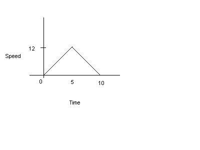

  • The speed time graph f a particle moving along a fixed direction is shown in the picture. Obtain the distance traversed by the article between ... (a) t = 0 s to 10 s and ... (b) 2 s to 6s
    For the first instance its just 1/2 * b * h = 0.5 * 10 * 12 = 60 m
    But for the second one, I don't know the value of speed (height). Therefore, how can I calculate area of the triangle for the distance?
You are exactly right that the distance traversed by the article is the area of that triangle. To do
(b), note that 0 to 2 seconds is a small right triangle on the left and 6 to 10 seconds a right triangle on the right. Find the areas of those two and subtract from your answer to (a). How do you find the heights of those? The simplest way is to use "similar triangles". Looking just at the right triangle from t=0 to 5, we see that it base 5 and height 12. The little triangle from t= 0 to 2 has base 2 and height "x". Since the two triangles are similar (they have the same angles), x/2= 12/5. Solve for the height x and use that to find the area. The right half triangle (from t= 5 to 10) also has base 5 and height 12. The small triangle from t= 6 to 10 has base 4 and height "x". Since the two triangles are similar, x/4= 12/5. Again, solve for the height x and use that to find the area.
Hi,
Thanks a lot for your help! The similar triangles one was really easy once I got the concept right. The distance for the part (b) is 36m according to my calculations.
