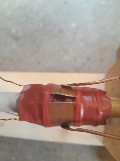

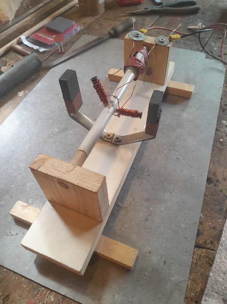

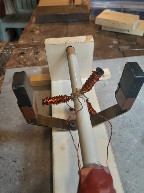

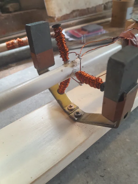

Homemade 3 coils dc motor will not move. Ive already checked that the coils are all wound in the same direction, that the brushed swap contacts in accordance to the coils position in the permanent magnetic field. The permanent magnets are not too far away. Im clueless as to what the issue could be.

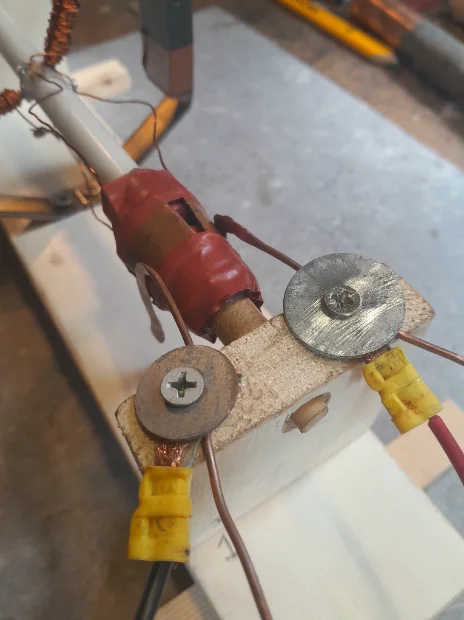

As stated earlier the coils are wound in the same direction, the magnets are not too far away and the brushes swap over at the correct time. I thought possibly friction could be the answer however after checking with my multimeter, the voltage through the commutator was only 0.3 volts when using a 6 Volt battery and when using a 9 Volt battery the reading was not much higher. I can't work out what could be causing this resistance. I would be gracious of any incite anyone could provide.
  • Homemade DC motor with a copper-wire coil wound on a rotor shaft mounted between two bar magnets on a wooden base, with red-insulated leads running to the commutator end.

  • Close-up of a homemade DC motor commutator on a wooden block, with two screw-mounted brass brush contact discs, red-taped copper coil, and yellow insulated spade terminals attached to the leads.

  • Close-up photo of a homemade motor commutator: two copper segments wrapped in red insulating tape, with bare copper wire leads extending from the coil on either side.

  • Close-up of a homemade DC motor rotor: copper wire coils wound on a white plastic shaft, soldered to a brass commutator strip, with carbon brushes on either side.

  • Homemade DC motor on a wooden base: a rotor of wire coils on a horizontal shaft between two wooden uprights, with two rectangular magnets mounted on either side and copper brush contacts at the commutator end.

Just got it working thanks to Scott above 👏, proper stator connection and I used 12volts power supply. Made it move but still some improvements to make!
berkeman said:
How is this different from your previous thread?
This motor has 3 coils not 2 like the previous. So a new set of issues unfortunately.
You need to mark the magnets so we know where the N and S poles are on the surface of those rectangular block magnets.
