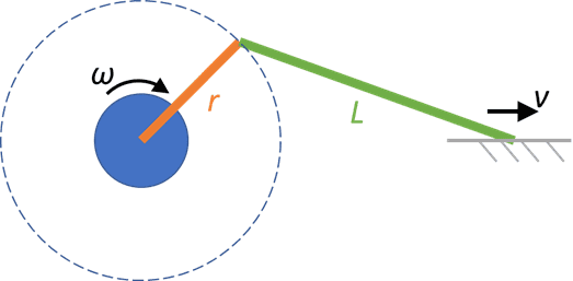

I am trying to design a mechanism which has a hydraulic cylinder driven by a step motor. The motor shaft is connected to the hydraulic cylinder piston via two rods of lengths r and L as shown in the below figure. I want the cylinder's piston to be driven at constant velocity v, so I am trying to solve for the rotational speed profile w (omega) that I need to drive the step motor with in order to achieve the constant linear velocity v.
Any help?
Diagram of a crank-slider mechanism: a blue circle with an orange crank of length r rotating at angular speed omega, connected by a green rod of length L to a slider moving right at velocity v along a grounded surface.
  • Diagram of a crank-slider mechanism: a blue circle with an orange crank of length r rotating at angular speed omega, connected by a green rod of length L to a slider moving right at velocity v along a grounded surface.
The arrangement you sketched will not produce constant velocity V. It will move back and forth in a sinusoidal motion, like the wheels of a steam engine.

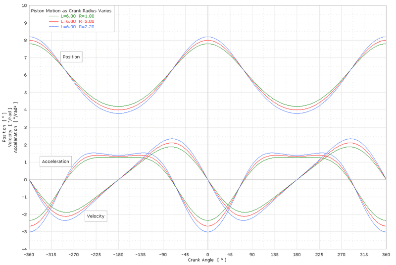

Asymptotic said:
From Wikipedia Piston Motion Equation article. Velocity is sinusoidal.
The velocity is sinusoidal if the driving shaft is rotating at constant RPM.
I am interested in solving for what the driving shaft rotational speed profile would need to be to drive piston at constant horizontal linear speed.
If we focus on just one stroke of piston from left to right (not continuous rotation of shaft). We should be able to derive a profile for the shaft angular speed that would result in a constant linear speed of piston for one stroke.

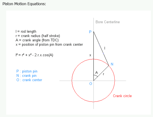

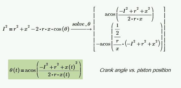

It seems like the easiest way to approach this is to:
  1. Use the piston motion equation's cosine law to solve for θ
  2. Assume θ and x are the only two variables, defining them as θ(t) and x(t)
  3. Define equation for x(t)
  4. Take partial derivative of resulting equation (d/dt)
A quick run through a symbolic math tool gets the following for θ and x:
Geometry diagram of a slider-crank: crank circle centred at O with crank pin N, connecting rod from N to piston pin P on the bore centreline, with labelled sides l, r, x and crank angle A from TDC, plus the cosine-law equation for l squared.

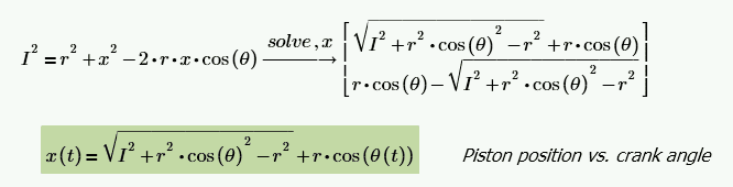

Use piston motion cosine rule equation to solve for piston position vs crank angle:
Symbolic solution of the crank-slider cosine law solved for x, giving x(t) = sqrt(I^2 + r^2 cos(theta(t))^2 - r^2) + r cos(theta(t)), labelled piston position vs crank angle.

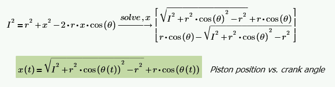

Alternatively, rearrange the equation to find crank angle as a function of piston position:
Solve-block output: I^2 = r^2 + x^2 - 2·r·x·cos(θ) solved for θ gives acos((-I^2 + r^2 + x^2)/(2·r·x)) and -acos((1/2)·(r/x)·(-I^2 + r^2 + x^2)). Below, θ(t) = acos((-I^2 + r^2 + x(t)^2)/(2·r·x(t))), labelled Crank angle vs. piston position.
You will need to assume an equation to describe x(t) with a constant velocity (maybe something like x(t)=(I-r)+v*t where I and r are the crank and connecting rod lengths and v is the piston speed) you should be able to take the derivative w.r.t. time and have a solution.
  • Geometry diagram of a slider-crank: crank circle centred at O with crank pin N, connecting rod from N to piston pin P on the bore centreline, with labelled sides l, r, x and crank angle A from TDC, plus the cosine-law equation for l squared.
  • Symbolic solution of the crank-slider cosine law I^2 = r^2 + x^2 - 2rx cos(θ) solved for x, giving x = sqrt(I^2 + r^2 cos(θ)^2 - r^2) + r cos(θ), with a second root shown; below it, x(t) = sqrt(I^2 + r^2 cos(θ)^2 - r^2) + r cos(θ(t)) labelled piston position vs crank angle.
  • Solve-block output: I^2 = r^2 + x^2 - 2·r·x·cos(θ) solved for θ gives acos((-I^2 + r^2 + x^2)/(2·r·x)) and -acos((1/2)·(r/x)·(-I^2 + r^2 + x^2)). Below, θ(t) = acos((-I^2 + r^2 + x(t)^2)/(2·r·x(t))), labelled Crank angle vs. piston position.
  • Symbolic solution of the crank-slider cosine law solved for x, giving x(t) = sqrt(I^2 + r^2 cos(theta(t))^2 - r^2) + r cos(theta(t)), labelled piston position vs crank angle.

Wale said:
Speed range of 0.5-4 inches/second. Stroke length range of 0.5-4 inches.
These requirements should be achievable with a ball screw by the way. It's easy to find ballscrew-driven stages which achieve faster speeds than this.

This is very helpful. Thank you very much!
