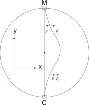

In opposite points carousel diameter D = 20 m, rotating with constant angular acceleration, located at the point C shooter and target M. Shooter aiming at a target without introducing amendments to the rotation of the carousel. What should be the angular acceleration of the carousel with that under these conditions, the bullet hit the target at the time the shot was carousel angular velocity ##\omega_0## = 1 rad / min, and the velocity ##v_0## = 200 m / s. Shoter and shooting conditions are assumed ideal. Neglect the influence of centrifugal force.
The equation of motion in non-inertial reference frame
##\frac{{d\vec v}}{{dt}} = - \left[ {\vec \beta \times \vec r} \right] + 2\left[ {\vec v \times \vec \omega } \right]##
Projected on the axis:
##\begin{array}{l}
\frac{{d{v_y}}}{{dt}} = 0\\
\frac{{d{v_x}}}{{dt}} = 2{v_y}\omega + \beta y
\end{array}##
and
##\omega = {\omega _0} + \beta t##
##y = {v_0}t - \frac{D}{2}## - from the first equation of motion
I finally got
##\frac{{d{v_x}}}{{dt}} = 2{v_0}\omega + 3{v_0}\beta t - \frac{{\beta D}}{2}##
integrating this equation, I get
##x=v_0 \omega_0 t^2+1/2v_0\beta t^{3}-1/4\beta D{t}^{2}##
From the ##y = {v_0}t - \frac{D}{2}## I find time, when the bullet hit the target (##y=D/2##)
##\tau=D/v_0##
when the bullet hit the target ##x=0##
solving ##0=v_0 \omega_0 t^2+1/2v_0\beta t^{3}-1/4\beta D{t}^{2}##
I find the angular acceleration. ##\beta=-\frac{4v_0\omega_0}{D}##
But it is negative!
Help me find the error!

TSny said:
How did you get the right side to be 0?
There is no forces acts in y-direction (I neglect the centrifugal force due to problem condition)
In the rotating non-inertial frame the pseudo-forces ##\vec{r} \times \vec{\beta}## and ##2\vec{v} \times \vec{\omega}## will have y-components.
Are you making an approximation? Since ##x## and ##v_x## of the bullet in the rotating frame will be very small during the flight, then you can neglect the y-component of the acceleration of the bullet in the rotating frame.
If so, then I think your analysis is correct. The negative value of the angular acceleration ##\beta## is what you should expect. Try to picture the rotational motion of the carousel.
But, if value of the angular acceleration ##\beta## is negavive, then I can simply use expression for angular velocity ##\omega=\omega_0-\beta t## instead of with "+" sign expression ##\omega=\omega_0+\beta t##, and I should expect the same but positive value of ##\beta##, but it is not. With ##\omega=\omega_0-\beta t## I give ##\frac{12v_0\omega_0}{5D}##.
You should get the same magnitude for ##\beta##.
Don't forget to change the sign of ##\beta## in the last term of ##\frac{{d{v_x}}}{{dt}} = 2{v_y}\omega + \beta y##
Oh, right. But this mean that the rotation of carousel is decselereted.
sergiokapone said:
Oh, right. But this mean that the rotation of carousel is decelereted.
That's right, in the inertial frame the carousel slows down and switches direction so that the target can get back to where the bullet will strike.
There are other solutions where the constant acceleration is positive. But these solutions are not realistic and you would definitely not be able to make the assumption ##a_y \approx 0## in the rotating frame for these other solutions.
