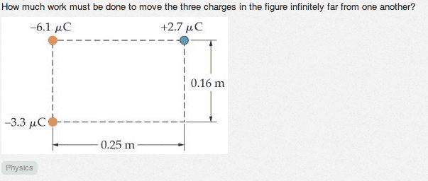

Moving three points infinitely away

U=kqoq/r ?
Please look at the attachments. I was wondering if someone could please check my work. That is all.
Thank you for your time!
