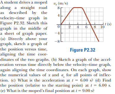

EDIT: For this part(b) of this problem,
Velocity versus time graph: v_x (m/s) on the vertical axis from about -8 to 8, t (s) on the horizontal axis from 0 to 10. The line rises from 0 to 8 m/s, stays flat, then falls linearly, crossing zero and reaching about -8 m/s.

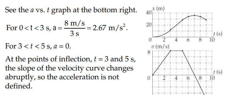

The solution is
Two graphs: x (m) against t (s) rising then peaking near 8 s, and v (m/s) against t (s) rising to 8 m/s, flat from 3 to 5 s, then falling; text at left gives a = 2.67 m/s² for 0 < t < 3 s and a = 0 for 3 < t < 5 s.
Graph of acceleration a (m/s^2) against time t (s): a = 4 m/s^2 from t = 0 to 3 s, a = 0 from 3 to 5 s, and a = -4 m/s^2 from 5 to 9 s, with gridlines at 2 s intervals.
However, isn't there more points of inflection than just ##t = 3,5 s ##? Points of inflection is when ##x'' = a = 0## so it should be ## 3 ≤ t ≤ 5 s##

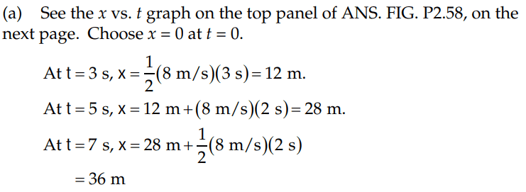

I also have a question about part(d):

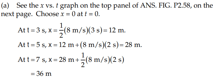

The solution is
Solution text for part (d): average velocity from t = 5 s to 7 s is (8 m/s + 0)/2 = 4 m/s; at t = 6 s, x = 28 m + (4 m/s)(1 s) = 32 m. Beside it, a velocity-time graph labeled ANS. FIG. P2.58.
However, could I tried solving for the position by finding the area under the velocity curve from t = 0 to t = 6 sec.
## 0.5 \times 3 \times 8 + 2 \times 8 + 1\times 4 + 1 \times 1 \times 4 = 34 m ##.
I don't understand what I have done wrong since I should be able to get the correct answer from areas.

  • Solution text for part (a): using the x vs. t graph, x = 0 at t = 0; x = 12 m at t = 3 s, x = 28 m at t = 5 s, and x = 36 m at t = 7 s, computed from areas under the velocity line with 8 m/s.

Callumnc1 said:
isn't there more points of inflection than just t=3,5s?
It should not refer to inflection points here. The first and second derivatives of v would need to exist and be continuous.

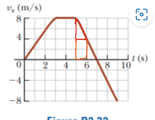

Also I still don't understand how I calculated the displacement wrong since there is no negative velocities from t = 0 to t = 6 sec
Graph of v (m/s) against t (s) with a red-dotted curve rising from the origin to about 8 m/s near t = 4 s, then falling linearly to the t-axis near t = 7 s; axis tick labels 2, 4, 6, 8, 10 are visible.
Many thanks!
  • Graph of v (m/s) against t (s) showing a red-highlighted curve that rises from 0 to about 8 m/s near t = 4 s, then falls linearly to below zero by t = 10 s, with grid lines and axis labels 0, 2, 4, 6, 8, 10.
Callumnc1 said:
Why would the second derivative of v need to exist and be continuous?
https://en.wikipedia.org/wiki/Inflection_point
How true, but you fooled me with the last two terms in
## 0.5 \times 3 \times 8 + 2 \times 8 + 1\times 4 + 1 \times 1 \times 4##.
If stopping at 6sec, where do those come from?

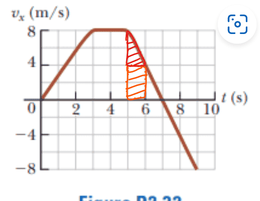

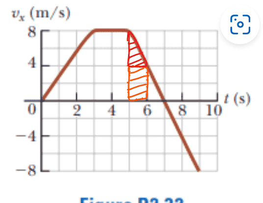

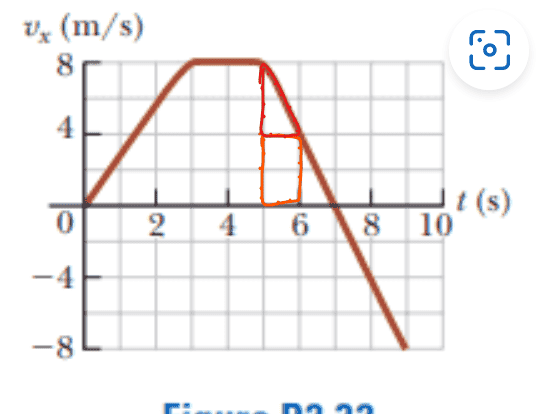

Sorry I made a slight mistake with the last term. It should be
## 0.5 \times 3 \times 8 + 2 \times 8 + 1\times 4 + 0.5 \times 1 \times 4 = 34 m ##.
The last two terms ## 1\times 4 + 0.5 \times 1 \times 4 = 34 m ## are accounted for here on the graph in red and orange.
Graph of velocity v_x (m/s) against time t (s): velocity rises linearly from 0 to 8 m/s by t = 3 s, stays at 8 m/s until t = 5 s, then falls linearly to 0 at t = 7 s and to about -8 m/s at t = 9 s. Shaded areas between t = 5 and 6 s are marked in red and orange.
The solution seems to account for only the orange triangle (##1 \times 4##) giving ##32 m##. However, I though displacement should the total area under the velocity curve over the interval ##[0, 6] s## so I included the red triangle to get ##34 m##
Let me know what you think!
Many thanks!
  • Graph of v_x (m/s) against t (s): velocity rises linearly from 0 to 8 at t = 3 s, stays at 8 until t = 5 s, then falls linearly to 0 at t = 7 s and to about -8 at t = 9 s. Red and orange shaded triangles and rectangle mark the area from t = 5 s to 6 s.

Well, when you put it like that, I agree.
The book mistake is that they found the average speed between 5s and 7s, instead of between 5s and 6s.
