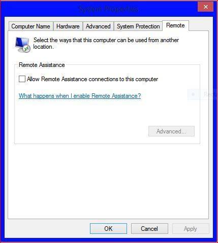

Keeping Remote Assistance unchecked might help some, I'm not sure...
I keep it unchecked on my computer, anyway..
Windows System Properties dialog on the Remote tab, with the Allow Remote Assistance connections to this computer checkbox unchecked and the Advanced button greyed out.

I was over there again the other day and noticed something new to me.
The ability to transfer control to an external user is built right in to Windows 7. You can configure it to let a user take control when you're troubleshooting something (for example, I was troubleshooting her printer). This is obviously what OCR was referencing in post 11 - the significance of which went right over my head at the time.
I have always assumed that, in order for someone to take control of your computer, you had to explicitly install and run a program. That's the way it was Back in the Day.
This is why I was so puzzled that someone could have been manipulated her system, yet I could find no trace of an installed program. (The caller must have told her how to go and tick that box.)
Thanks MS, for making it so convenient for someone to destroy my mother's computer.
I think that box is checked by default. You have to actually turn it off if you don't want that 'feature'.
When that box is checked, the system will respond to remote assistance requests, but it still requires the user at the system to accept the connection. An external user cannot simply connect using the Remote Assistance application unsolicited.
