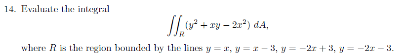

In this problem I have drawn out the region specified and noticed two sets of parallel lines indicating to me that a change of variable(u and v) are able to be used to solve this integral.
I decided that u=y-x and v = -2x-y then solving for x and y I obtain x= (u-v)/3 and y = (4u-v)/3
From here I can compute the jacobian but I want to be sure the work above is correct before I move on. Can anyone please confirm?

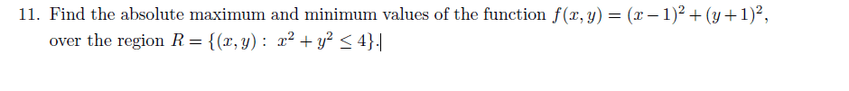

For this second problem can anyone verify that it has been completed correctly
I think I have the right absolute minimum and maximum. Can someone also verify ?

I would work the second problem as follows:
We are given the function:
$$f(x,y)=(x-1)^2+(y+1)^2$$
Computing the first partials, and equating them to zero, we find:
$$f_x(x,y)=2(x-1)=0$$
$$f_y(x,y)=2(y+1)=0$$
This yields the critical point $(x,y)=(1,-1)$, which is within $R$. Using the second partials test for relative extrema, we find:
$$f_{xx}(x,y)=2$$
$$f_{yy}(x,y)=2$$
$$f_{xy}(x,y)=0$$
Hence:
$$D(x,y)=4$$
Since $$f_{xx}(1,-1)=2>0$$ and $$D(1,-1)=4>0$$ we conclude this critical value is a relative minimum.
$$f(1,-1)=(1-1)^2+(-1+1)^2=0$$
To check the boundary, we may use Lagrange multipliers.
The objective function is:
subject to the constraint:
$$g(x,y)=x^2+y^2-4=0$$
and this yields the system:
$$2(x-1)=\lambda(2x)$$
$$2(y+1)=\lambda(2y)$$
which implies:
$$\lambda=\frac{x-1}{x}=\frac{y+1}{y}\implies y=-x$$
Substituting for $y$ into the constraint, there results:
$$x^2+(-x)^2=4$$
$$x=\pm\sqrt{2},y=\mp\sqrt{2}$$
Thus, the extrema values of the function on the boundary are:
$$f(\sqrt{2},-\sqrt{2})=(\sqrt{2}-1)^2+(-\sqrt{2}+1)^2=6-4\sqrt{2}$$
$$f(-\sqrt{2},\sqrt{2})=(-\sqrt{2}-1)^2+(\sqrt{2}+1)^2=6+4\sqrt{2}$$
Thus, the absolute extrema of $f$ over $R$ are:
$$f_{\min}=f(1,-1)=0$$
$$f_{\max}=f(-\sqrt{2},\sqrt{2})=6+4\sqrt{2}$$
