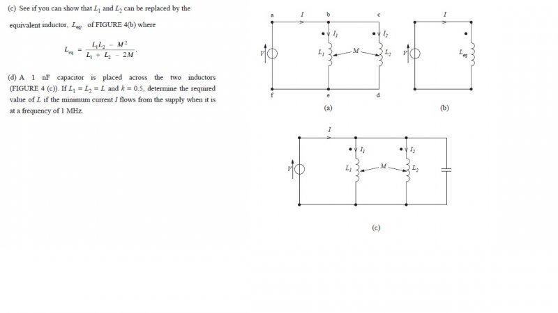

The discussion focuses on solving a homework problem related to mutual inductance using two primary approaches. The first method utilizes the formula m = k√(L1L2), where m represents mutual inductance, k is the coupling coefficient, and L1 and L2 are the self-inductances of the coils. The second approach involves applying Kirchhoff's Voltage Law (KVL) to derive equations for the currents I1 and I2, allowing for their calculation through simultaneous equations.

I have two ideas:
1. using m=k√L1L2
or
2. assume they equal and solve it ??
Write the kvl equations for the two currents I1 and I2. Solve for I1 and I2.
