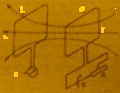

How to explain mutual inductance with the image I attached? There are two conducting frames, one has a source of DC and a variable resistor, the other just a galvanometer. What I should conclude from this picture that the flux is F1=alpha*I and F2=c*F1, and Ein=-M*dI/dt. How? Is the current I, the induced current in the left frame or the changeable current in the right frame? Is F1 the flux for the left or the right frame?

Mutual Inductance is a defined quantity and it tells you the induced emf in one coil, caused by the rate of change of current in the other. This is along the same lines as self inductance. So E = M dI/dt. Why or how it works is not considered in that definition. It's a quantity that can be used on its own as long as the elements are linear. (i.e. no saturating c

You may be trying to second guess this thing. There will be an induced emf which could cause a current to flow (if the circuit is not open circuited) this current will affect the current that flows in the first (primary) coil because of the emf caused by the secondary current. etc. etc. . . . So it's all jumbled up and when you are using AC, can be described in an Impedance Matrix - shown in this link . If. the impedances are only Inductive then you will have a Reactance matrix of the same form.

So it is the current of the primary coil. The flux through it is c*I, and the flux through the second coil is alpha*c*I?
Mututal inductance is just the overall behaviour of the coils. There are many different designs for a pair of coils that will have the same Mutual Inductance and the Flux is a separate issue. Are you asking the right question for your needs?
I just need to derive the induced EMF. Is my reasoning correct?
If you know the M then you would know the emf in the other coil.
E2 = M12dI1/dt (The M suffix may be the wrong way round but no matter)
But what has that to do with Flux? Using M misses out the magnetic flux - same as the self Inductance value.
As I commented earlier, I don't think you are asking the right question because I have given you the answer to what M stands for. Could you expand on those initial formulae you are using and say where they come from? How "deep" are you prepared to go?
M=c*alpha and Ein=-dF/dt, and F=M*I. Now could I get a response to my previous posts.

c and alpha are proportionality constants. Here is what I got: DC passes through the right coil, but it changes over time because of the variable resistance so it produces a magnetic field with a flux through the left frame of F=c*I, and through the second: F=c*alpha*I=MI. The induced EMF in the right coil is EMF=-dF/dt=-M*dI/dt, that's the full story as I understand it. Is my reasoning correct?
V = -M dI/dt is the formula I quoted way back and it's correct. Are you just trying to justify that with the steps in your argument? Can't you find a proper derivation somewhere on the Web? Your steps seem to be showing that M is the product of two other constants of proportionality - fair enough. I think the problem is (and it was giving me trouble) that you can't easily actually find what those two constants are - from measurement at least. But it's pretty easy to measure M, though. Calculating M is not easy, in most cases.
