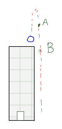

Consider the famous kinematics equations $$x_f=x_i+v_i\cdot t+\frac12at^2$$ My question is: does this equation work for every point A & B along the parabola formed when dropping an object?

I know it must be a simple thing I'm missing, but I can't figure it out, here's my try. Consider two points A & B such that ##x_{A,i}=R+x_{B,i}## and ##v_{A,i}\neq v_{B,i}## (for generality), then I should show that
  1. it implies that ##x_{A,f}=R+x_{B,f}##
  2. it implies that the final velocities won't change (how do I formulate that?)
I arrived at the following equations $$v_{A,f}-v_{B,f}=v_{A,i}-v_{B,i}\\x_{A,f}-x_{B,f}-R=t(v_{A,i}-v_{B,i})$$
And for that equality to happen we must have ##v_{A,i}-v_{B,i}=0## but this contradicts our assumption that ##v_{A,i}\neq v_{B,i}##, since clearly if -- for example -- you have an object falling onto the ground, if you take two distinct points in its trajectory, the velocity at each point won't be the same.
So what am I missing?
(here's a visualization of the situation)

Ah, forgot about time, I should have added the following constraints ##t_B=T+t_A##, but again this doesn't yield much...

I'm thinking of parabolas in space parametrized w.r.t time. (like the one I drawed)

I only treated the system w.r.t to a coordinate system in which the ##x##-axis is vertical.

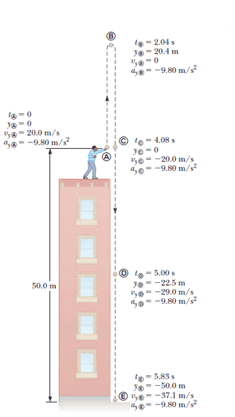

Okay, sorry, it is all my fault for using a notation that I didn't properly explain. I'll use an example to illustrate what I want to show
A stone thrown from the top of a building is given an initial velocity of 20.0 m/s straight upward. The stone is launched 50.0 m above the ground, and the stone just misses the edge of the roof on its way down as shown in the figure below.
Diagram of a stone thrown upward from a building roof, with labelled points A to E and kinematic data at each: A at t=0, y=0, v=20.0 m/s, a=-9.80 m/s²; B at t=2.04 s, y=20.4 m, v=0; C at t=4.08 s, y=0, v=-20.0 m/s; D at t=5.00 s, y=-22.5 m, v=-29.0 m/s; E at t=5.83 s, y=-50.0 m, v=-37.1 m/s. The building height is marked 50.0 m.
In this example, I used the point A as the initial point. Now consider as if we're working with points B & C. All the values shown in the figure are relative to A. You can see that ##t_B=\rm{2.04 \;sec}## -- with that notation -- with respect to A, but it would be ##0\;\rm sec## with respect to B, or ##-2.04\;\rm sec## with respect to C.
Now what happens when the time passed from the initial time ##t=5\,\rm sec## ##\color{green}{\text{(with respect to A)}}##, i.e. what's the position & velocity at that time?
Well, we know that $$x_f=x_i+v_it+\frac12at^2,\tag{1}$$ we have that ##x_i=0{\rm\;sec},v_i=20.0\rm\;m/s## hence we get that $$\bbox[8pt,lightgreen,border:3px green solid]{\color{}{\large x_f=-22.5\rm\;m}}\tag{2}$$ Now, ##\color{blue}{\text{with respect to C}}##, we have that ##x_i={\rm\;0m},v_i=-20.0{\rm\;m/s},t=\big(5-4.08\big){\rm\;s}=0.92{\rm\;s}##, putting these values in ##(1)##, and sure enough: $$\bbox[8pt,skyblue,border:3px blue solid]{\color{}{\large x_f=-22.5\rm\;m}}\tag{3}$$ Now, ##\color{red}{\text{with respect to B}}## we have that ##x_i=0{\rm\;m},v_i=0{\rm\;m/s},t=\big(5-2.04\big){\rm\;m}=2.96{\rm\;m}##. Putting these things in ##(1)## yields $$\bbox[8pt,pink,border:3px red solid]{\color{}{\large x_f=-43\rm\;m}}\tag{4}$$ I assume these would lead us, under the correct transformation, to ##x_f## with respect to A.
But basically you got the idea, showing that no matter what points B & C we choose, it will always the same result, up to the change in the distance between them.
Well, why use x when all your labels in the picture are y? But this is a minor point.
You did not make any mistake.
The position is -22.5 m in respect to A but -42.9 m in respect to B. Did you expect to get the same value? You are measuring (same) position from different origins. It will be unlikely to get the same value. If you look at the figure you can see that the distance from B to D is larger than from A to D.(or than C to D).
Oups, another mistake, I wanted to say that we would get the same result between these points if we translate one to another. I'll edit the earlier post.
I don't know what you mean by this "translate one to another". By changing the origin, the values of the coordinate will change and there is no mistake.
The positions will change but speed and acceleration won't change if you translate the origin to a different point along the same line.

In this case I translated A to B, the difference between the x-coordinate of the two is only 2.04 m, and doesn't help to get 22.5 m out of the 43 m, why?
Also, I agree that the change in the coordinate only amounts to a change in the origin, so there will be no differnece, okay. But why the speed won't change? I mean, conceptually, yes, it will be the same, but I'm looking for a rigorous derivation.
