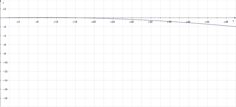

Sorry, I don't see where you're having a problem with it...
Out of curiosity I plugged some numbers into Mathematica and it reports that the curve [itex]y(x) = -0.00121 x^2 + 0.0209 x[/itex] satisfies the necessary conditions: [itex]y(0) = 0[/itex], [itex]y'(0) = \tan(1.2^\circ)[/itex], [itex]y(50) = -2[/itex] (all distances measured in feet). I don't know anything about highway construction, but that seems like a reasonable shape for a road.

diazona said:Sorry, I don't see where you're having a problem with it...
Which looks like what? Can you post it?

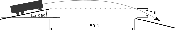

The image I recall from the Mythbusters show is a snap shot of the movie frame showing an LA style elevated highway with a section missing. Trying to estimate the actual geometry from such an image is difficult due to parallex error. The launch ramp would be 2 feet higher than the landing ramp (in DaveC sketch it is shown lower). The launch ramp would be at an incline of 1.2 degrees to the horizontal and the landing ramp at 0 degrees in my understanding. This could be a reasonable approximation for a missing section of elevated highway I suppose.
Edit: sketch attached.

diazona said:OK, but I thought you would have been able to plot a function yourself :-/
It's not very steep. I know roads with much higher grades and which probably have greater curvature too.
Hm. So the bus is leaving the ramp at almost horizontal and it has to fall less than 2 feet in the time it takes to cover a 50ft horizontal distance.
