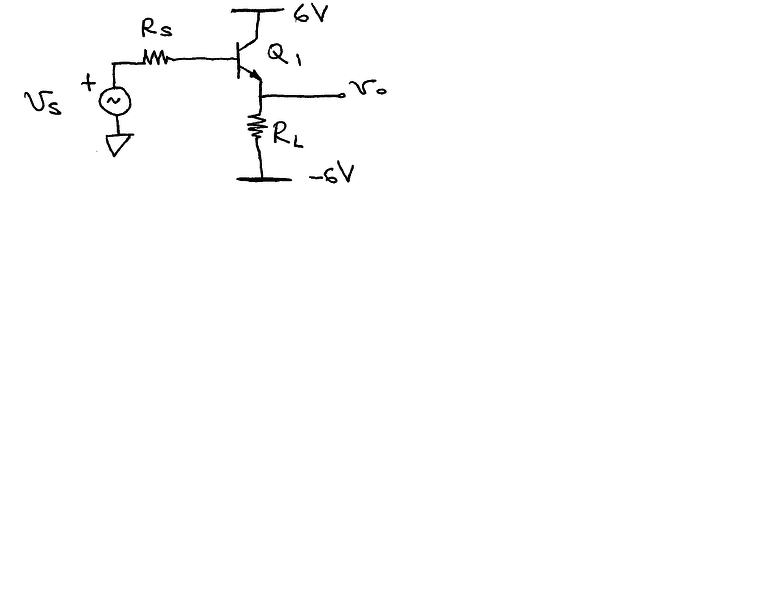

I am having troubles biasing this transistor circuit
Mainly, I cannot find Ic
The only equation I can come up w/ is 6 - Vce - ie*Re - (-6) = 0
but it doesn't help me, as I do not Vce
I do not know how to find Ib, Vs is messing me up, I am not sure how to analyze this...
The given values are beta 100 Vbe sat 0.3 Vbe 0.7 Va = 100 (early voltage)

My only thought would be to midpoint bias it? idk,
say that at cutoff Vce = Vcc - Vee = 12 volts, and take half as 6 volts for Vce (bias)
Ic (sat) approx = Ie sat ------> 12 - Vcesat (0.3) - Re * ic = 0
Given Re I could solve for Ic, then take half?
I see an emitter follower where the emitter voltage will be roughly 0.7V less than Vs minus the drop across Rs.
Ic will be determined by the voltage across Rl with [Vs -(drop across Rs) - Vbe] on one side and -6V on the other.
Drop across Rs is Ic/Beta. Vbe is around 0.7V.
Do you understand how the emitter follower works? Basically the transistor supplies whatever current is required for the emitter voltage to be a Vbe drop (about 0.7V) less than the base voltage.

If you don't know Vs you can't determine anything. So I am confused about what you are trying to determine.
Basically Ic = (Vs - (-6))/Rl not accounting for Vbe or drop across Rs.

Then you write the equation in Vs like I did. The answer has to have the variable Vs in it and I've given you all the pieces.

Vs isn't part of the biasing arrangement, it represents the signal to be buffered/amplified. Most similar circuits, to be useful, allow a signal input! In many cases the signal is capacitor-coupled to the base, so it certainly is there. Whether the AC is shown as being in series with the DC, or in parallel with it, is immaterial, all that matters is that the signal be impressed upon the bias.
It might seem that there is no biasing voltage source in your circuit here; but there is, and it is zero volts. If the transistor base were connected by a piece of wire directly to ground it would mean the AC coupled to the base would also get shorted to ground, so not be amplified.

The signal AC has zero average value, so the signal contributes nothing to the bias. The bias contributes no noise because we use a DC power supply which is smooth and well filtered.
Vs is not a biasing supply; the ~ indicates it is AC, so that source represents the input signal.

With all the information given you should be able to easily determine the Ic for any given Vs value. This is not about "bias".
I propose you solve the following and post the answers:
Assume Beta = 100, Rs = 10K and Rl = 1K.
1. Calculate Ic for Vs = 0V DC.
2. Calculate Ic for Vs = +1 DC and Vs = -1v DC.
There is no bias as such. At least not in the sense that I think of when biasing a transistor circuit. It is a DC coupled emitter follower and the output voltage (at the emitter) follows the input voltage Vs. (offset by a few voltage drops which we have explained)
