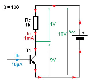

Circuit schematic of an NPN transistor T1 with beta = 100, Rc = 1k resistor, Ic = 1mA, Ib = 10µA, Vcc = 10V supply, showing 1V across Rc and 9V across the transistor.
For this circuit with ideal transistor (CCCS) any base current large than:
Ib > (Vcc/Rc)/β will saturate our BJT.
But in real life ideal transistor don't exist. For any real world transistor the β is not constant. Beta varies with Ic, Vce, temperature. And what is worse, every single transistor will have different beta value and beta will changes for different operating conditions also.
Also in saturation Ic = Ib * β do not hold any more.
So too overcome this problem with beta and saturation we are forced to use "overdrive factor" or "Forced Beta" trick.
We simply increase the base current well beyond Ib > (Vcc/Rc)/β (beyond minimum beta). We do this to make sure that we have enough base current to put the transistor well into saturation for every condition we have in our circuit.
