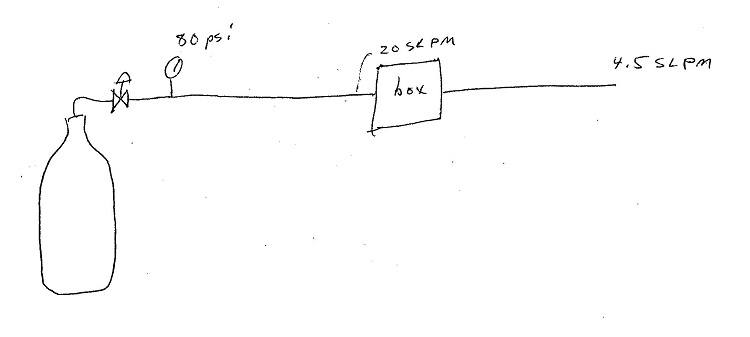

I am trying to figure out how to calculate pressure of an exhaust line.
We have a product container we purge with nitrogen to create a low oxygen environment The container is roughly 12x12x12 inch. It has an exhaust port with a 1/4 inch poly line that measures 0.17 inch ID. The top of the container is a door with a rubber gasket. We are a little surprised at how little flow the exhaust port can exhaust before it blows the lid gasket and the nitrogen blows out the door seal. With 20slm input flow at 80psi we measure a max of 4.5 slm out of the exhaust line and the rest blows out the door seal. Long story short is the pressure generated in the exhaust line at 4.5slm overcomes the door seal. I would like to know how to calculate the pressure of a line where I know the line length, ID and flow or better yet a chart. And let's just say the line pressure is 5psi, how does that pressure of 5 psi in a 0.17 line translate to the internal force on a 1 cubic foot container?

Your description is a little unclear. The sketch below show what I think you are doing:
If this is correct, then the pressure in the box is unknown, so you cannot calculate pressure drop in either the supply or discharge tubing.
One cubic foot is 28.3 liters. Your supply flow rate should be determined by the allowable time to purge atmospheric air after opening the box. If the incoming nitrogen enters so as to get good mixing (not aimed straight at the discharge opening), then a good rule of thumb is that it will be 63% purged after one times the box volume and fully purged after five times the box volume of nitrogen flows through. That would be 28.3 X 5 = 140 standard liters of nitrogen. Divide by the allowable time to get the flow rate. If the allowable time is 20 minutes, the required flow rate will be 140 / 20 = 7 SLPM. If you want a more accurate number, search purging calculations.
