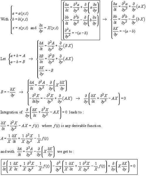

ygrl
Hi, I'm not good in math but I need to learn how to solve these differential equations.
It was really hard to write in TeX form, sorry.
d a / d t = d^2 a / d y^2 + d / d y (a * d x / d y)
d b / d t = d^2 b / d y^2 - d / d y (b * d x / d y)
d^2 x / d y^2 = - (a - b)
I need to solve for a, b and x.
What type of DE is this, a PDE? Which methods should I use?
It's difficult to answer since the typography of the equations is ambiguous.
Since symbol "d" is used everywhere instead of "d" in some places and "" in other places, it is impossible to know if each derivative is a partial or a total derivative.
Morover, in the third equation, since a and b are functions of t, then x might be a function of t. So x=x(y,t) instead of x=x(y) has a different meaning . [ except if a/t = b/t ]

Hi, jackmann's notation is correct. Instead of d there should be [tex]\partial[/tex]
Thanks for helping me out. I'm going to read the book that you've mentioned.
Well, in this case, analytical solving will be very arduous, probably impossible in present state of knowledge.
It is possible to reduce the set of three DPE to one DPE only with one unknown function only X(y,t) , as shown in attachment.
But this DPE is a fourth order non-linear DPE. So, numerical solving is probably the only realistic way.
Numerical treatment would probably be better directly with the original set of three PDE than with only one transformed DPE, because further integrations in ordrer to compute the functions a(y,t) and b(y,t) would be rather complicated and because it would need to transform the boundaries conditions as well.
