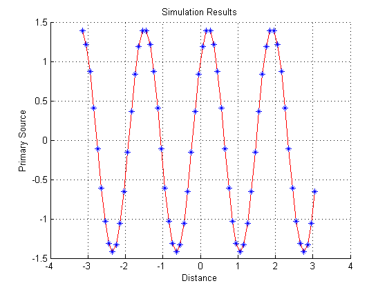

Hi Everyone,
I am a new Matlab User, I am want to plot the equation y=cos(A*x) + i*sin(A*x)
where A = 400*pi/340 and want to plot y and vary x from pi:0.1:pi
clear all;
close all;
A = 400*pi/340;
x = -180:0,1:180;
a=cos(A*x);
b=i*sin(A*x);
i= imag(b);
hold on;
grid on;
plot(a,i, 'r-*','MarkerEdgeColor','b');
xlabel('Distance');
ylabel('Primary Source');
title('Simulation Results');
You defined x in degrees, then used the radian trig functions. There are degree counterparts, like sind(x), that calculate the trig values in degrees. So choose one or the other, but make it consistent.
It's a best practice to use elementwise operations for your functions. Of course, the operators * and .* are the same when a scalar is involved, but it will save you headaches in the future.
Your call to plot confuses me. You are plotting i against a? I think this is why your current plot looks strange. You should be plotting a + i against x.
Code:
clear
clc
A = 400*pi/340;
x = -pi:0.1:pi;
y = cos(A.*x) + imag(i.*sin(A.*x));
hold on; grid on;
plot(x,y,'r-*','MarkerEdgeColor','b')
xlabel('Distance');

thanks you so much for your quick reply

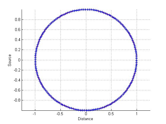

can you let me know if this is also correct ?
clear all;
close all;
A=400*pi/340;
theta= -2*pi:0.03:2*pi;
y=exp(1i*A*theta);
grid on;
hold on;
plot(theta,y, 'r-*','MarkerEdgeColor','b');
xlabel('Distance');
ylabel('Source');
The only thing is that y = exp(1i*A*theta); yields a vector of complex numbers. If you care only about the real part, you should plot real(y), if you care only about the imaginary part, you should plot imag(y).
When you use plot(theta, y) it ignores all imaginary components.
HOWEVER, when you supply only a single imaginary argument, MATLAB plots the real part vs the imaginary part. For your second example, it produces the unit circle
Code:
clear all; close all;
A=400*pi/340;
y=exp(1i*A*theta);
grid on; hold on;
plot(y, 'r-*','MarkerEdgeColor','b');
axis equal;
xlabel('Distance');
ylabel('Source');
Edit: I should have used different axis names

okay i understand that now. I really appreciate your help and your time. God Bless you
