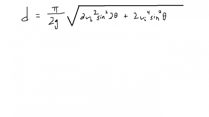

Idk if anyone has figured this out, but I believe I've found a new equation for the length of an arc traveled by, say, a football.
I uploaded a picture of it. I don't have any experimental proof for it, but I used tricky mathematical manipulations with standard projectile equations, the perimeter of an ellipse, and the Pythagorean theorem. Do you think this could get published? Sorry if I sound like a noob

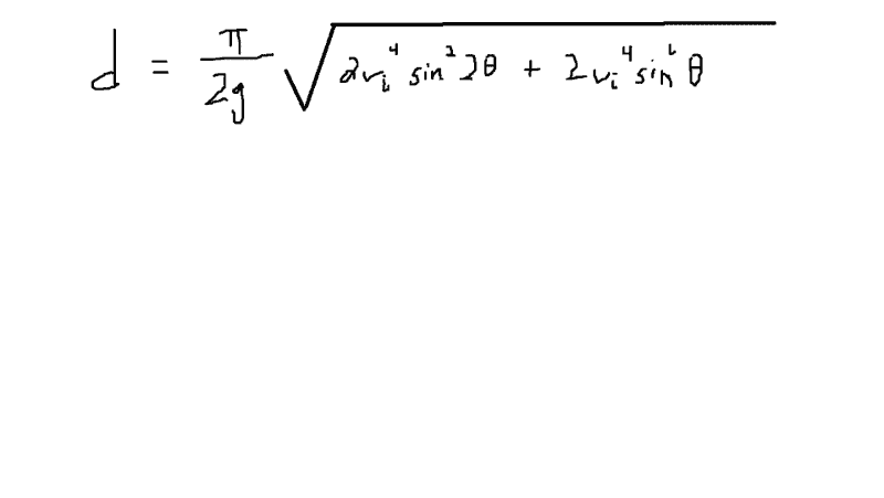

Crap. That sin at the very end of the square root should be to the 4th power. Sorry
Here is the fixed image.

What is the first symbol in the root?
No, there is no new formula to find for arc lengths of parabolas.
A football does not follow an ellipse.
The arc length of a parabola is hard to presented as a elementary function.

It takes quite a while to explain how I arrived at this equation, but I guess I'll explain anyway even though I'm wrong.
The perimeter of an ellipse is given by the equation 2pi times the square root of a^2 + b^2 over 2. Rearranging this and making some substitutions, I can say the perimeter equals pi x c x √2. C in this case is the distance between the furthermost point on the major axis to the furthermost point on the minor axis.
Now, I thought the flight path of a projectile sort of looked like an ellipse, so I substituted equations for a^2 and b^2.
These are x = (vi)^2(sin2x)/g and y = vi^2(sin^2x)/g. I applied the Pythagorean theorem to get c, and plugged it into the original deal with pi x c x root2. I cut it in half, since it's clearly only the top half of the ellipse.
It was tempting to think it was similar to an ellipse since, like a projectile, has a point where its rate of change is 0.
So I wouldn't say laughably wrong. It seems like good work and maybe some little mistakes.
The first thing to do is to decide if you want to use a parabola or an ellipse. Most projectile problems use parabolas. This is appropriate if gravity is approximately uniform over the trajectory, but if you want to model intercontinental ballistic missiles or satellites then you may need to use ellipses.
This formula for the perimeter of an ellipse is incorrect.

I got my formula for the ellipse from the Internet. I know it's not exact, but an approximation rather. I'm only in Calculus I (going into Calc II) so I haven't really studied conic sections (calc-related) yet. Thanks for the info and links though.
The approximation is bad once the ellipse deviates significantly from a circle. A football will rarely follow anything close to a (half-)circle.
