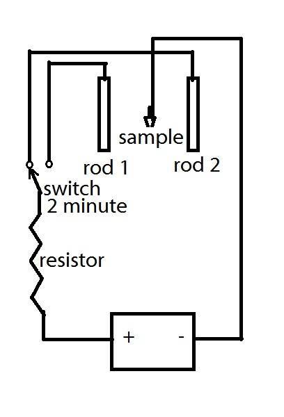

I think there may be a misunderstanding with what you mean by "switches polarity". Do you mean switch power from one rod to the other every 2 minutes like this not so good paint picture where only one resistor is required?

Anthonytsi said:
full or "hot" flow of current [...]One sending and one receiving voltage.
That does not make sense.
Please show a sketch of your setup.

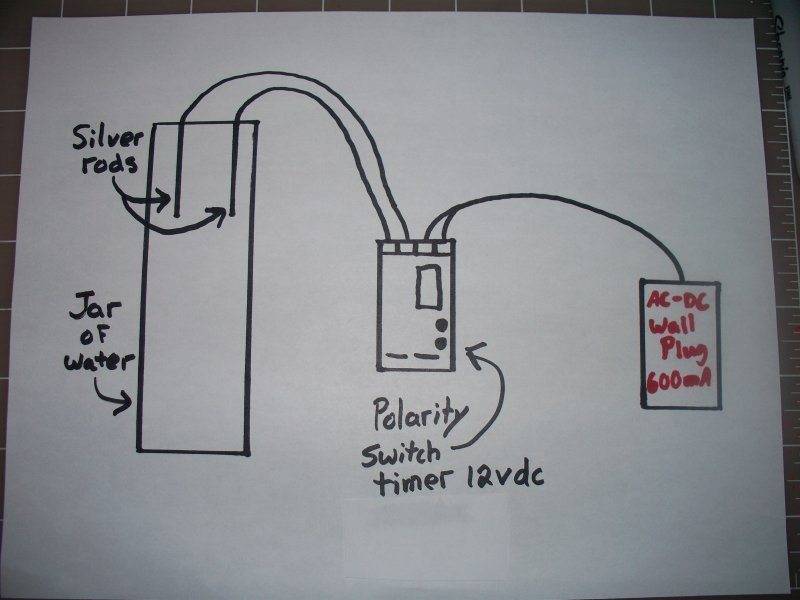

My setup is very basic.

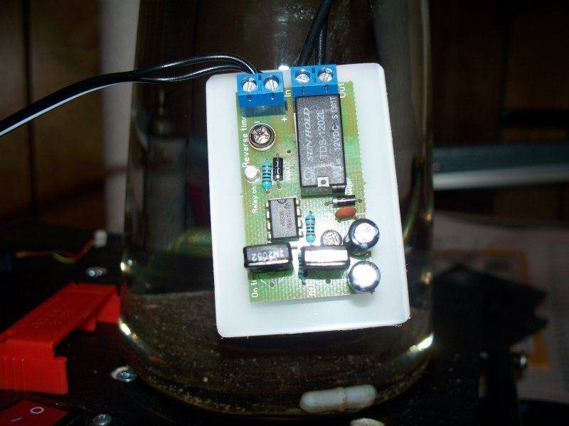

I have a polarity switch with variable timing plugged into my wall outlet at my house. The adapter for the timer DOES convert AC to DC as the timer is a DC unit. Sorry for leaving that out. I imagine that point might be important.
This polarity switch will run a standard motor in forward then reverse depending on the time I have set for it to do so. I tested this.
There are 2 leads from the switch that go to each silver rod suspended in water.
I used to hook up a standard 9v battery to make the silver solution. I noticed that only one rod would produce unless I turned the plug on the battery around. At that point the other rod would produce.
I use distilled water, so the process takes some time to get going. I usually spike the water with silver solution to get the ball rolling faster.
This is the polarity timer/switch. The output is 12.3vdc. I need to get that output to the rods down to 9v.
And the outcome being that after some hours you end up with a tiny pile of silver "dust" under one rod? Is that it? While your reversing timer may well evenly share the effort between the rods, you may just end up getting half as much silver from each, so no net gain? Was this something you devised, or is it standard recommended practice? Does one rod liberate a white fog of miniscule bubbles into the water---if so, then indeed periodic reversal is a good technique.

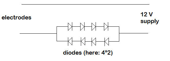

The best way to drop the voltage from 12.3V to 9V here is not with a resistor, but with a couple of rectifier diodes. You'll need 4 or 5 diodes, the type you would buy to make a low voltage power supply. Rated at 50V or 100V and 1 amp will be good and robust. Connect them in series, and place them in one of the leads where polarity does not reverse. Measure the voltage across the silver rods to see how close to 9V it becomes. Each diode loses about 0.7V at low current. These are better than a resistor here.

Back in post #2 in this thread, mfb pointed out you can pair each diode with a parallel one that's reversed then it will conduct in both directions, showing 0.7v drop regardless of current reversals. So you need 8 to 10 diodes now. Almost any sort will do, I just recommended power diodes because they have stronger leads and are more likely to survive an accidental touching of the silver rods! Open up the power supply from a junked VCR or desktop computer box and you'll see big diodes you can carefully salvage using a pair of sidecutters. (First short out big capacitors in case they have held a charge, if recently used. Make sure it's unplugged from the mains!) Don't bother trying to straighten out the leads of diode you salvage, more bending can weaken them. Just solder them into two strings, one going one way, the other in the reverse. Good luck!

Back in post #2 in this thread, mfb pointed out you can pair each diode with a parallel one that's reversed then it will conduct in both directions, showing 0.7v drop regardless of current reversals.)
We'll recognize you as the blue-skinned guy who doesn't suffer from winter colds & flu??
You said...you can pair each diode with a parallel one that's reversed then it will conduct in both directions, showing 0.7v drop regardless of current reversals.)
Can you please give me a drawing of that using my crude hand drawing picture from above. That sounds reasonable, I just need to see it.
