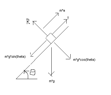

did you make the free body diagram?
oh, sorry! I forgot to attach it... >_<;;;
http://img297.imageshack.us/img297/3359/diagram2im0.gif
I suppose what confuses me is the fact that they're on ramps; I don't know how/where to draw the gravity part.
(apologies if this is frustrating for you. I'm just really bad at physics.)
nooooooooooo
this is what a free body diagram for such a situation looks like.
now make the other one. write the appropriate equation ie. Fnet = m*a.
eliminate T from both the equations. you have "a", find "m" and show us what you got. ok??

The weight acts at the centre of gravity (mass) of the block.
i guess OP is asking the direction of gravitational force andrevdh

I figured out how to do the free-body diagram right this time, and got:
http://img254.imageshack.us/img254/5139/diagramca9.gif
\SigmaFx = m2gsin\alpha - T = m2a.
and
\SigmaFx = T- m1gsin\beta = m1a.
so if I solve for T it would be m1a + m1gsin\beta, and substitute that into the first equation to figure out m2a.
with grouping like terms, plugging in numbers, solving, &c, I got 11.0 kg.
...would that be right?
(and a big thank you for the help!)
i didnt calculate the values, but the method you described, answer should be alright.
